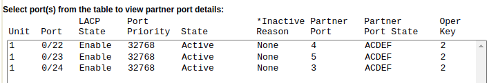

Right now we do run "successfully" a Link Aggregation LAGG with LACP protocol having 3 Cat Cables attached since some years already. But the scenario is the same if you do not run a Link Aggregation but just add this multiple IP addresses to a single NIC.
FreeNAS/TrueNAS and the connected managed switch are reporting fine about the Link Aggregation as you can see here:
Switch screenshot - reporting LAGG is fine and active:
* switch device: HPE 1920-24G Switch JG924A

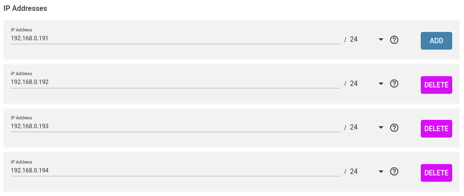

Multiple iSCSI and NFS connections are connected via the IP addresses 192.168.0.191 up to 192.168.0.194 without any recognized issues.
So far so good!

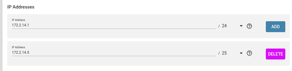

INFO: related to this post: can-lan-port-have-multiple-ip-addresses-of-same-subnet-mask-or-different-subnet
  • multiple IP addresses with SAME subnet are allowed.
  • multiple IP addresses with OVERLAPPING subnets are disallowed.
But TrueNAS does not give a hint, that OVERLAPPING subnets are discouraged.
  • maybe there should be a hint on such overlapping subnets being discouraged!?
QUESTIONs:
  • Is it wise to have multiple IP addresses with same subnet on LAGG or NIC-Interface? Wouldn't this lead to routing issues or performance impacts?
  • Why was/is it allowed in FreeNAS/TrueNAS GUI to have multiple IP addresses with SAME subnet? How are they separated from each other? Is this a special technique? Will this lead to performance loss or routing issues?
  • Why was/is it allowed in FreeNAS/TrueNAS GUI to have multiple IP addresses with overlapping subnets? How are they separated from each other? Is this a special technique? Will this lead to performance loss or routing errors?
  • Is having multiple IP addresses with same subnet the proper way to achieve another little step of separation for NFS and iSCSI? Besides from authentication techniques such as CHAP for iSCSI and Authorized Hosts/Authorized IP addresses for NFS etc..
  • What is the best way in TrueNAS to detect errors in package routing/network traffic?
Finally:
  • So the INFO about overlapping but not identical subnets was just informative and we do not use such setup.
  • The multiple IP Addresses with same subnet on the other hand is used actively in our setup and we are concerned if returning back to just one single IP address is advised.
Thanks in advanced for your appreciated feedback.

Multiple addresses in the same subnet on the same interface are perfectly fine. Addresses in the same subnet on different interfaces aren't.
jgreco
Resident Grinch
May 29, 2011
18,680
[*]Is it wise to have multiple IP addresses with same subnet on LAGG or NIC-Interface? Wouldn't this lead to routing issues or performance impacts?
Done correctly, IP aliases (the correct term for this) have negligible performance impact unless you are trying to do thousands of them, at which point it does become slightly problematic.
It isn't clear what routing issues you believe this could cause. Again, done correctly, it shouldn't, however, once you get up into the thousands, you do need to be aware that some switchgear has a limited size of MAC forwarding tables, and you can definitely run into a situation where the switch goes into ARPocalypse Now mode.
[*]Why was/is it allowed in FreeNAS/TrueNAS GUI to have multiple IP addresses with SAME subnet? How are they separated from each other? Is this a special technique? Will this lead to performance loss or routing issues?
It's allowed to have multiple IP addresses for the same reason you're allowed to have a single IP address. This is how we do IP networking. If you cannot have an address, your service is unreachable.
[*]Why was/is it allowed in FreeNAS/TrueNAS GUI to have multiple IP addresses with overlapping subnets? How are they separated from each other? Is this a special technique? Will this lead to performance loss or routing errors?
Overlapping networks is generally bad and you generally should not do it. However, FreeNAS is not your mommy and daddy, and there are lots of stupid things it does let you do.
[*]Is having multiple IP addresses with same subnet the proper way to achieve another little step of separation for NFS and iSCSI? Besides from authentication techniques such as CHAP for iSCSI and Authorized Hosts/Authorized IP addresses for NFS etc..
No, it is not "THE proper way". Again, FreeNAS is not your mommy or daddy, and will generally let you set you up things the way you need. It is perfectly fine, and doesn't bother anyone/anything, to have iSCSI and NFS on the same IP. Likewise, it doesn't bother anyone/anything to have them on separate IP's. "THE proper way" is the way in which you need it to work, as long as that is not at odds with proper IP networking design. So as long as you are not doing something tragically bad, YOU get to define "THE proper way" for your own network.
There are definitely things you can do that are tragically bad, such as putting multiple ethernet interfaces on the same network and expecting this to handle traffic input/output on a per-interface basis. That article will explain many of the details of that badness, and also provides insight into your related question of why multiple IP's on a single network works fine.
[*]What is the best way in TrueNAS to detect errors in package routing/network traffic?
You hire a competent server administrator and network administrator (maybe the same person, often not). Your NAS can only do what you tell it to do, but has no magic to analyze whether what you have told it to do is "wrong". FreeNAS is not your mommy or daddy, but these two hires I spoke of are definitely proxies for mommy and daddy. ;-)
[*]So the INFO about overlapping but not identical subnets was just informative and we do not use such setup.
[*]The multiple IP Addresses with same subnet on the other hand is used actively in our setup and we are concerned if returning back to just one single IP address is advised.
Hope this has cleared it up for you.
