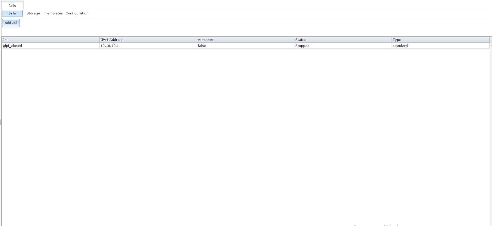

Hello, everybody!
I need to move installed and configured jail from network segment with internet to sefment without.
i have created exporting file successfully with
warden export jail_name
, moved it by flash to another network segment, than import it by
warden import /path_to_wdn/
But:
[root@NAS2] ~# warden list
ID                       AUTOSTART    STATUS       TYPE
OFF                      Disabled     Stopped      standard
[root@NAS2] ~# jls
   JID  IP Address      Hostname                      Path
     1  10.10.10.1      glpi_closed                   /mnt/apps/jails/OFF
[root@NAS2] ~# jexec glpi_closed /bin/sh
Why warden shows me that ID is "OFF"? why status is closed, but i can exec /bin/sh in jail? Why i can configure that jail by web (settings is not saving)?

Hello, anybody. Today i have returned to my problem vs import jail to another segment again, because i have decided, that i need glpi in my closed (phisycally vsout internet) segment. And i have done it. Maybe somebody need the same. My steps:
  1. Go to the freenas in segment vs internet and create/configure our jail
  2. In console warden export jail_name
  3. Copy result .wdn file to usb and move this to freenas in closed segment
  4. Go to the freenas in closed segment and in console warden import /path/jail_name. Now you have jail vs ID OFF (watch vs warden list).
  5. Rename zfs pool of imported jail vs zfs rename to name you need.
  6. Rename .OFF.meta. folder to .jail_name.meta.
  7. warden start jail_name
Profit
