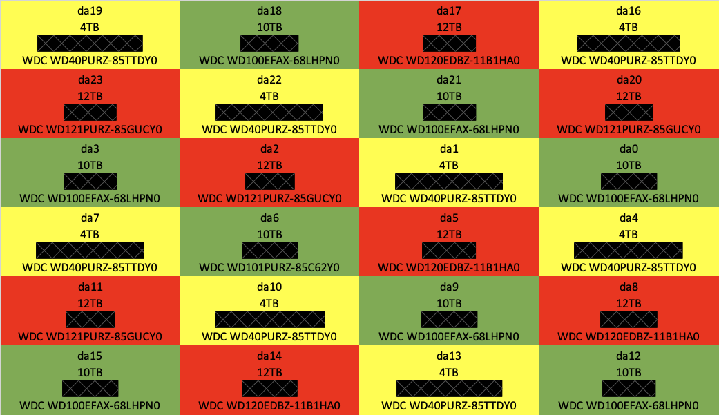

I would say that your proposed actions are not something that would be common... even if they are fine to do, I don't think it's something that would make it to a feature due to so few people needing to do it and the time and consideration needed for making such a feature clear enough to be well understood.
If I were to do something like that (and actually I have done it in the case of 3 disks), I would need to take into account the position in the chassis as I stagger my VDEVs across the chassis (for heat distribution) and 6 backplanes to avoid loss of any one VDEV in the case of a backplane unit failure:
My 3 VDEVs are RAIDZ2 in case anyone is wondering.
