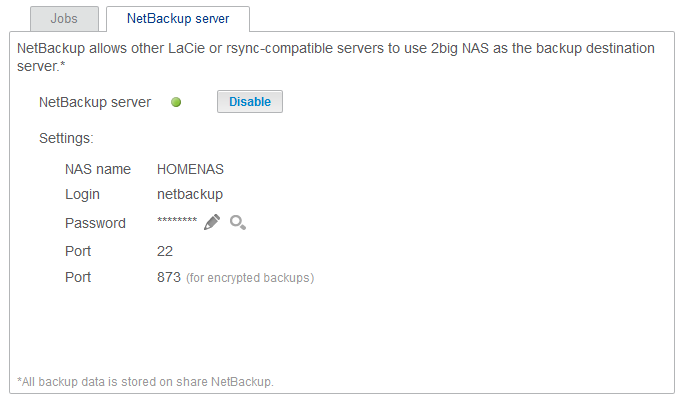

Humm.. Haven´t tried this, anodos... The Lacie NetBackup gives me these infos:
NAS Name, Login, Password and port (22 or 873 for encrypted backups). And I have 192.168.0.10 for Lacie IP.
I already created on FreeNAS an User "netbackup" which is the Lacie´s Login... and with the password Lacie gave me.
What would be Command syntax inside "Add Cron Job" window? Should I put the User "netbackup" or the Daemon?
The directory seems to be automatically inside a "\\NetBackup" Lacie creates, but I read in a Forum that I must have another directory inside it for this to work.. Please give me a syntax thinking that the "NetBackup" folder is at the root of Lacie.

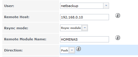

Besides the TERM error, it shows right under it: rsync: @ERROR: Unknown module 'HOMENAS'
My Rsync Task is like this:
...and at the Lacie's Dashboard is like this:
And at the router, both 22 and 873 ports are opened.
It all seems to be right, but the errors are still there. :(
