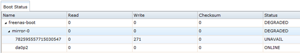

Hi all,
I've got a warning that the boot volume is degraded. I have 2 sandisk cruiser fit X 16GB mirrored for the boot volume. How do I know which is the faulty one?
If I got to boot status I get this:
Under storage > view disks I got this:
Hardware in my signature.

I switched the system off and I noticed one of the USB sticks is flashing. Would that be the faulty one?
Jailer
Not strong, but bad
Sep 12, 2014
4,977
Take one out and try and boot. If it doesn't' boot you know it's the bad one.
mvcad
Feb 25, 2018
116
Didn't think of that. Thanks!. It worked!
FYI, it was the blinking one!
