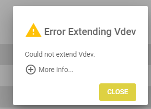

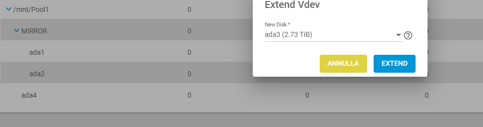

on the 2 TB ada4 disk if I do expand, it gives me an error

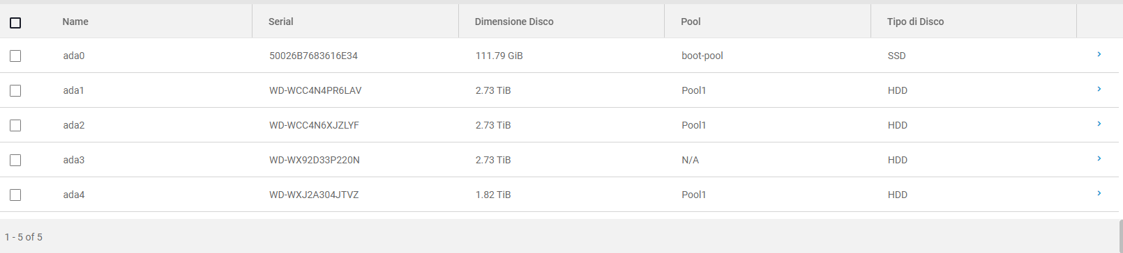

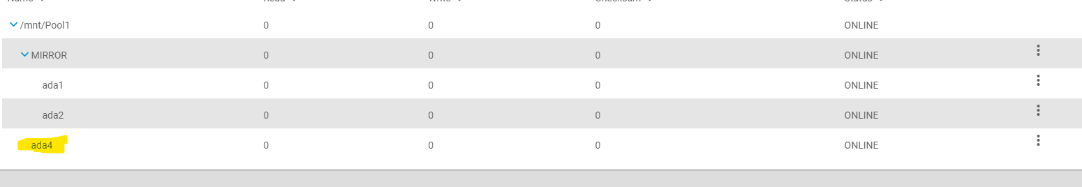

basically I'm left with a new 3TB disk which is outside mirror 1 made up of 2 3TB disks, even if I expand mirror 1 with the new 3TB disk it gives me an error that I can't.
How can I fix everything?

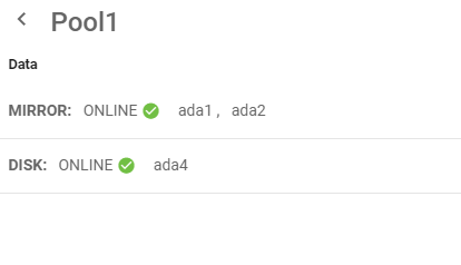

now there is mirror 1 with 2 3tb disks,
the ada4 2tb disk left alone and the new 3tb disk that I can't add anywhere.
how do I solve it?
can't I merge the 2 vdevs?
or do I have to restore mirror 2 but how do I do it? do I have to add another 2 TB disk because otherwise there is no way to add the 3 TB disk?
