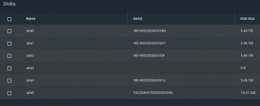

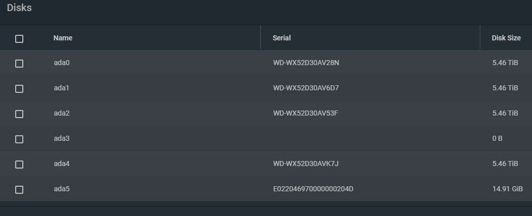

I am assuming that the dead drive is ada3 as it is absent in the Storage > Disks section. Further the #3 drive in the unit is the only one not blinking green at present.

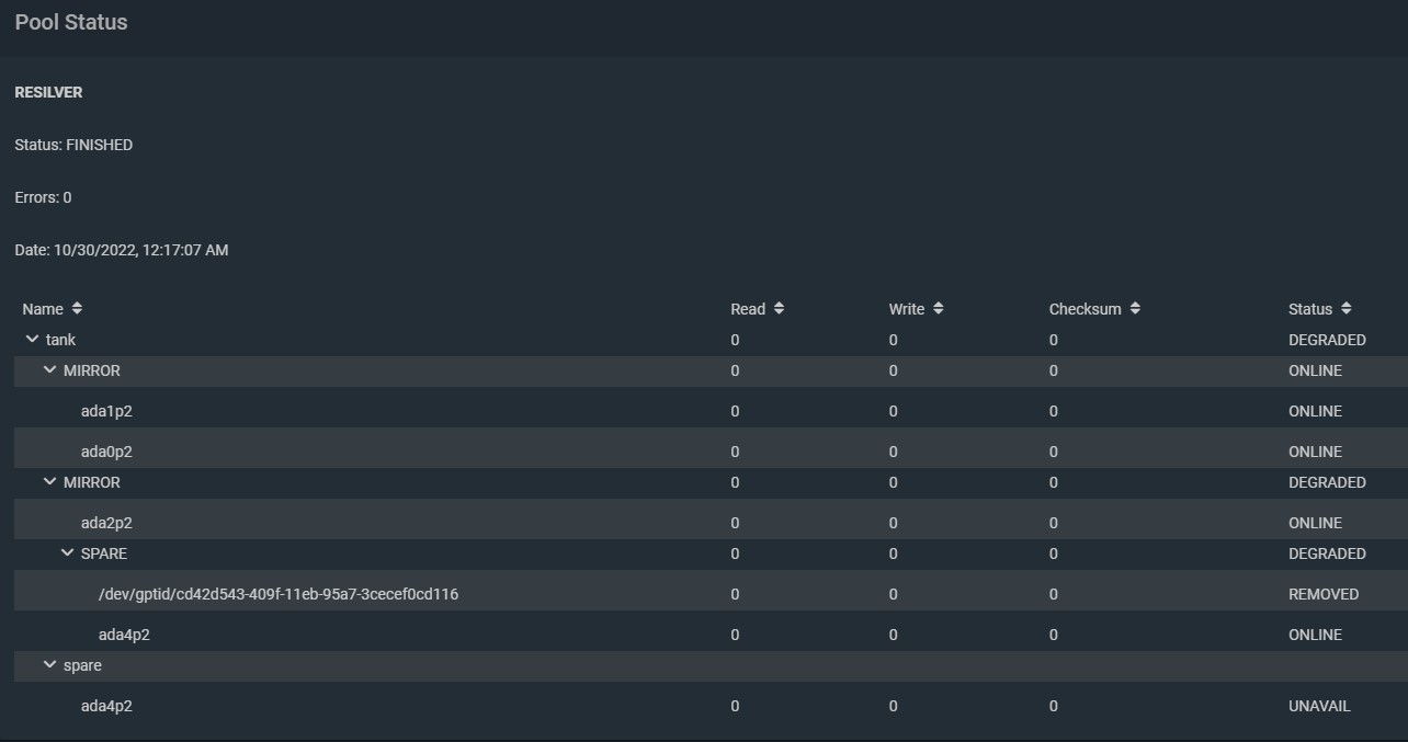

I do not understand what i am seeing on the Pool Status page. As to which drive is down. Or if there is a complete drive failure would it even show on the Pool Status Page. So i don't know if there is even an entry to "offline" to begin the replacement process.
Best i can tell is that one drive from the 2nd mirror failed and a spare was utilized for the resilvering.
So what are my steps now? Do i just pull the dead drive and replace it with the new. And then that drive becomes the new spare for the array? Or which one do i "offline" then install to become the new spare?
