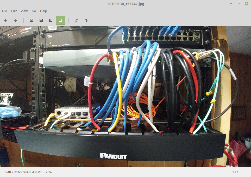

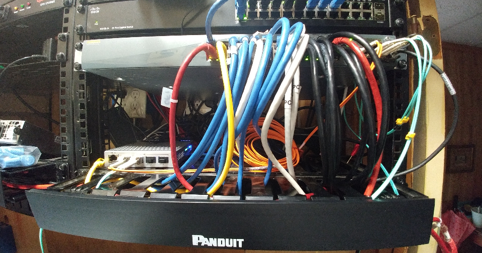

Small little box - can you find it?
Up-linked to my Aruba and with my workstation connected via SFP+

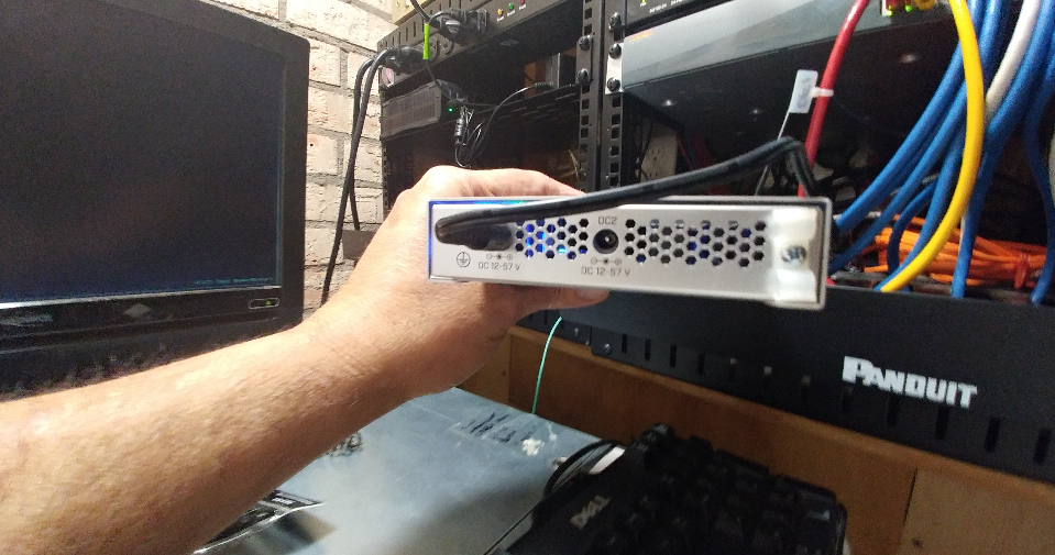

Redundant power supplies. Can also be powered from PoE, but didn't try.

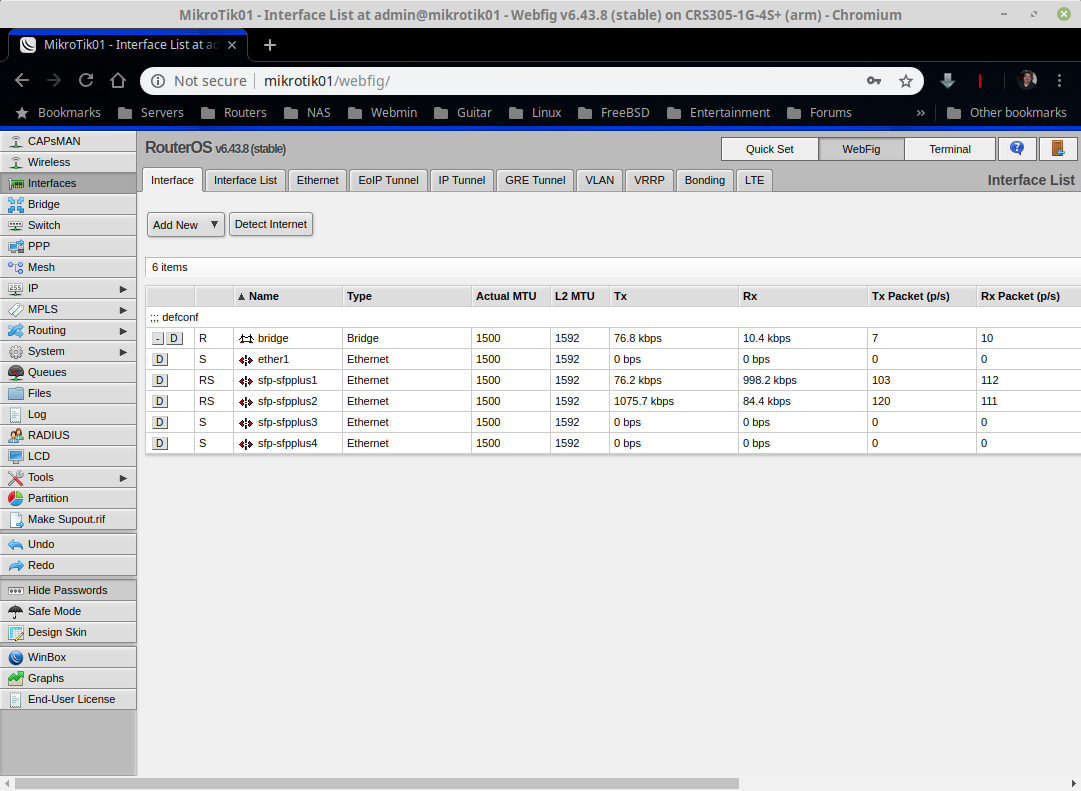

GUI showing interfaces

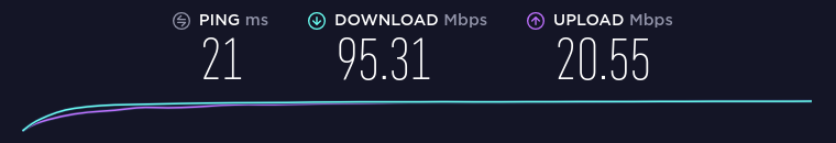

Same internet performances as with Aruba
Unit came pre-configure in bridge mode, so nothing was needed to start using it. I did change the IP address to match my network and have access to the GUI from my workstation.

Nice. That is your rack at home?

The switch one.

Rack is more organized than mine

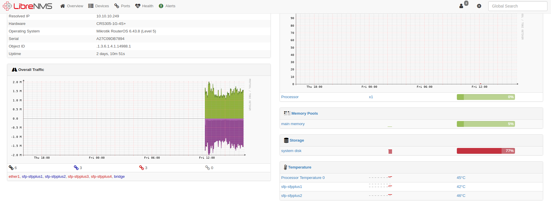

Two days running

Is that normal 40+ deg for spf? Never watched mine
melloa
May 22, 2016
1,749
From its specs:
Tested ambient temperature-40°C to 70°C
