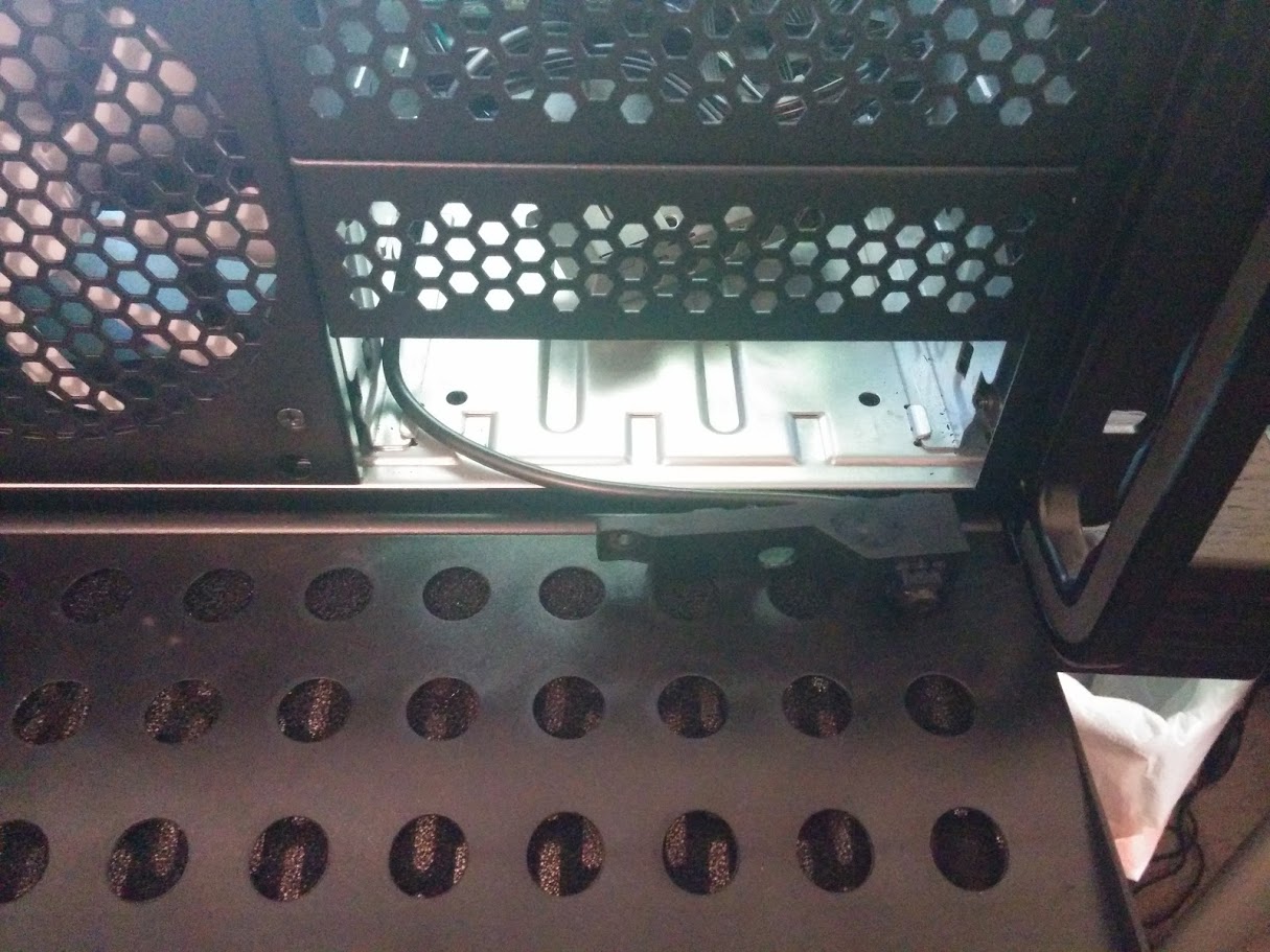

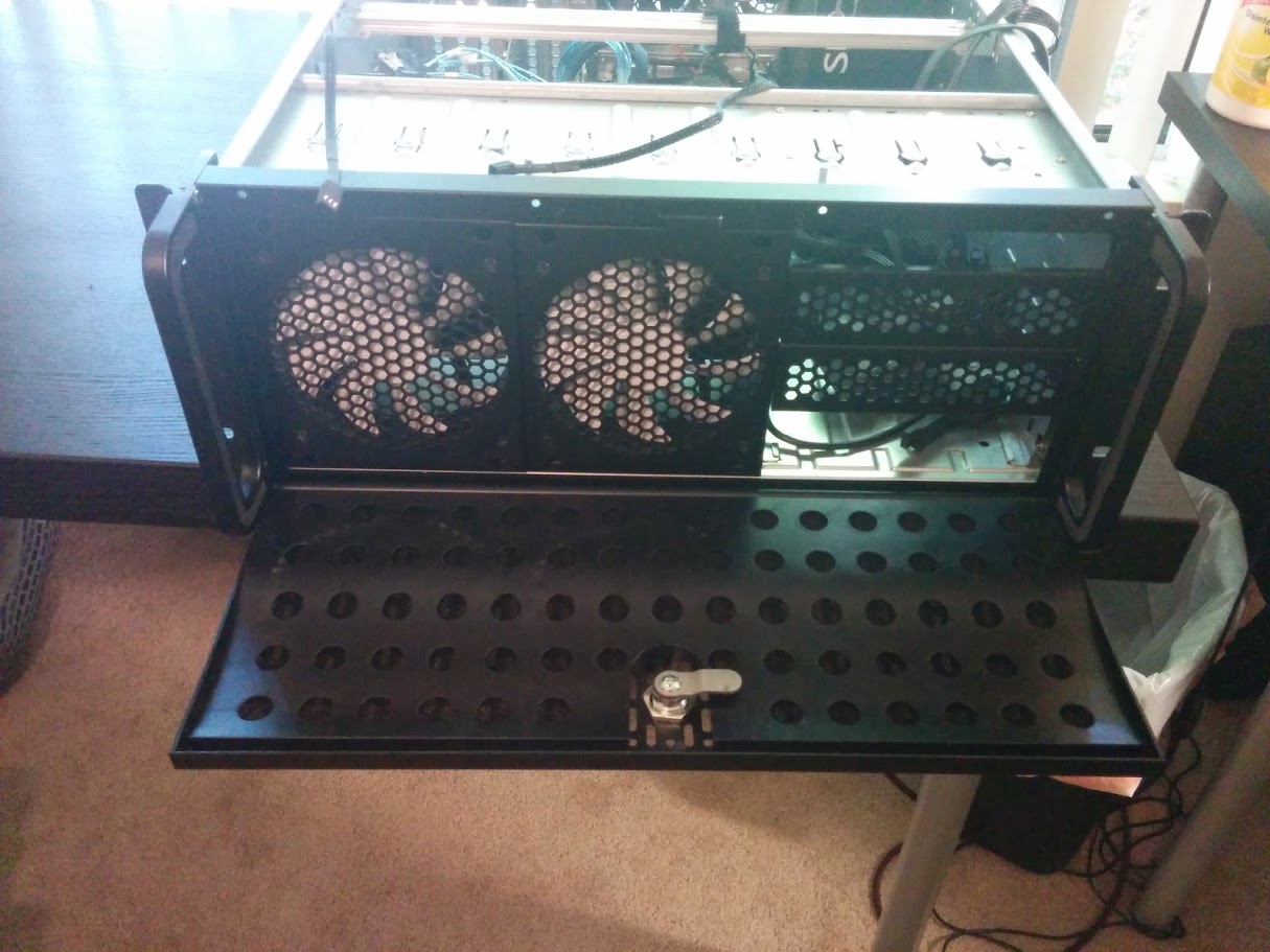

  • Front: I removed the included Rosewill Front I/O and the bottom 3.5" so I can reach in and press the power button
  • Powerbutton: A picture of my ghetto-rigged power button

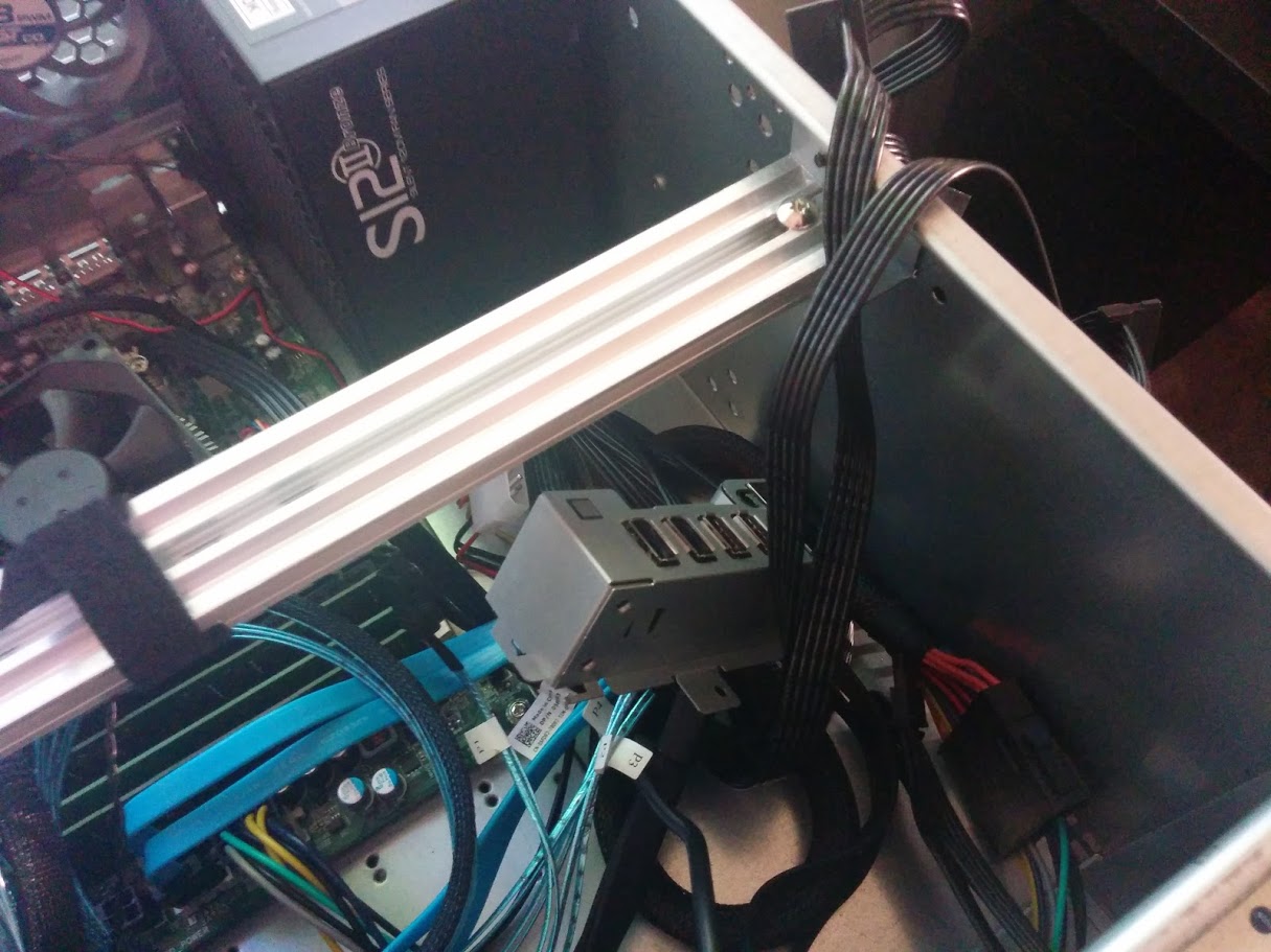

  • FrontIO: The Dell T20 stock Front I/O, tucked inside the case

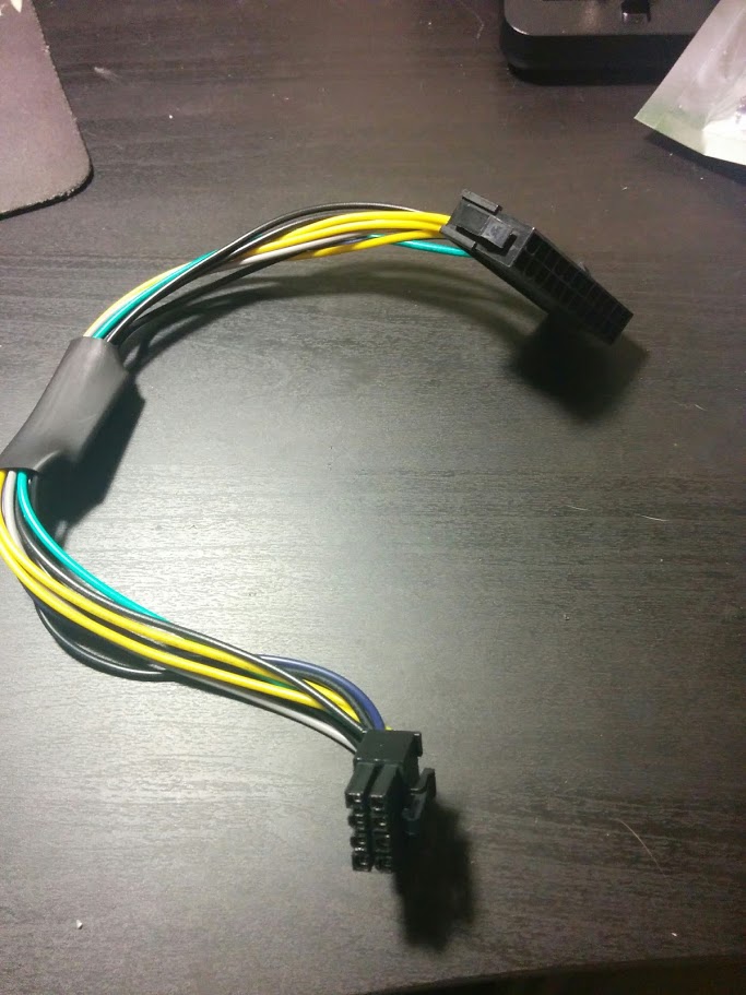

  • 8PinCable: A shot of the cable that I used to go from 24 pin -> Dell 8 pin, has some form of shrink wrapped PCB in the middle.

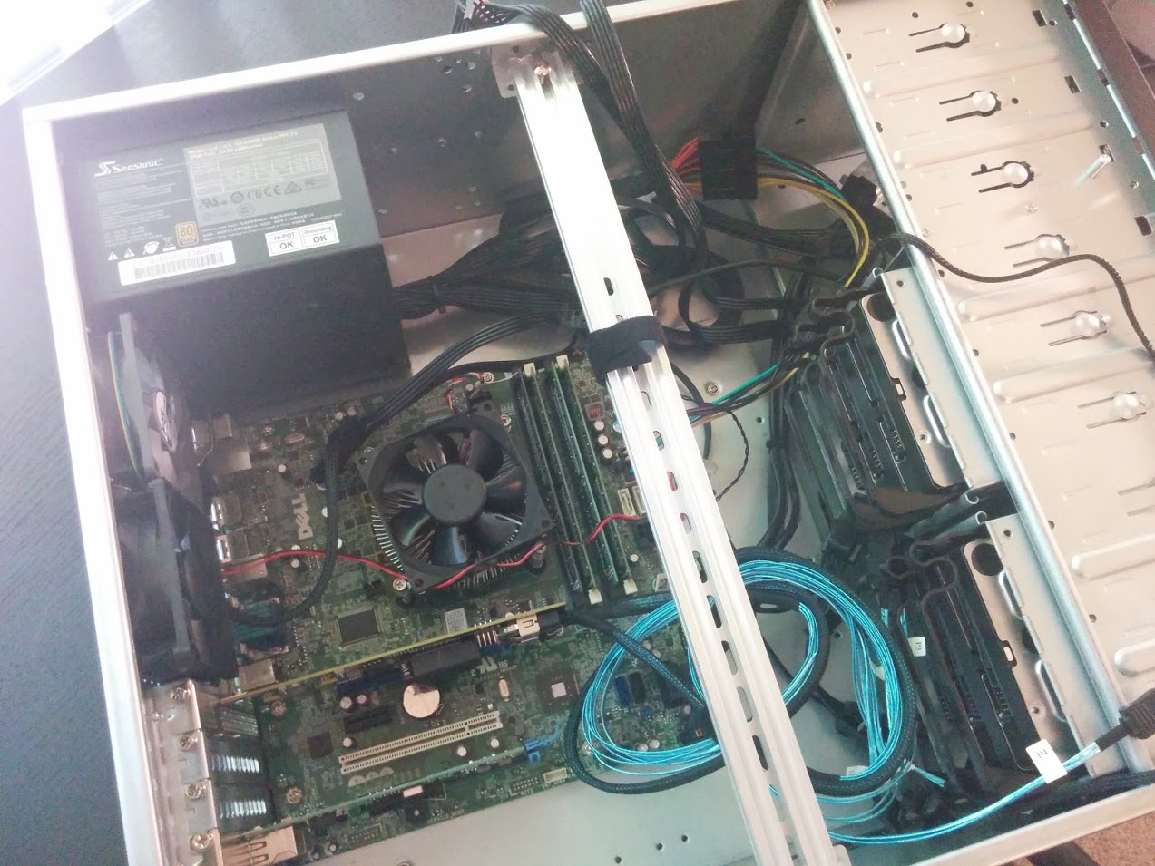

  • Inside: My lazy, un-managed cable mess. Note the velcro on the support bar, that holds the case T20 ambient thermal sensor!
Also forgot to note that I did not bring over the Chassis Intrusion switch and disabled it in BIOS to squelch any alarm. I moved the ambient thermal sensor though and have it wrapped up as that also will throw an alarm if missing.
