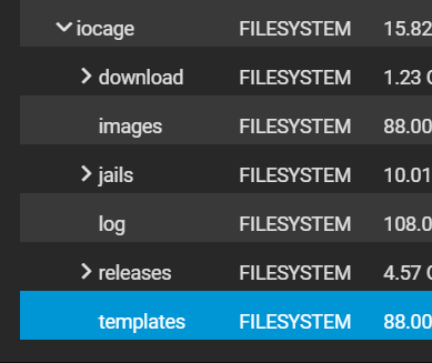

So, I messed up with acl and iocage pools. I was having problems with accessing iocage files with the SMB user, so I applied ACL to all the bits recursively, without realising I was messing up the whole thing (I am a total noob)
I stripped ACL from possibly everywhere in the iocage pool, but I can't get the jails to work anymore.
what should the permission for these be? how do I restore them? if I restore a freenas backup, will it be sorted?
very unclear. there are like 50 different ways to make a backup that could be called "a freenas backup". if you mean the config backup...then no, your pool permissions will not, afaik, be affect by that at all.
um. what? why are you trying to access iocage files with smb at all. that...sounds like a bad idea. iocage files should only be accessed by iocage.
I just did this myself not long ago, if in a different way, and, while I'm hardly a guru, I'm relatively experienced in freenas and *nix.
In my case, I fixed my jails by rolling back from snapshots to a time when I was less of a moron before i broke it.

thanks,
restoring the config did not help indeed.
I removed ACL from all the pools and then I created a new pool to see what the default permissions were. I replicated those and I was able to fix the problem, as far as I know.
the reason I was messing up with this, is because I wanted to change configuration files for some of the jails but it wasn't letting me from smb.
