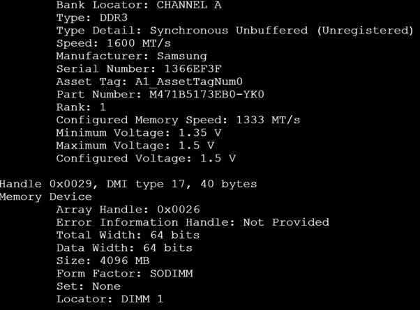

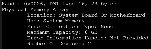

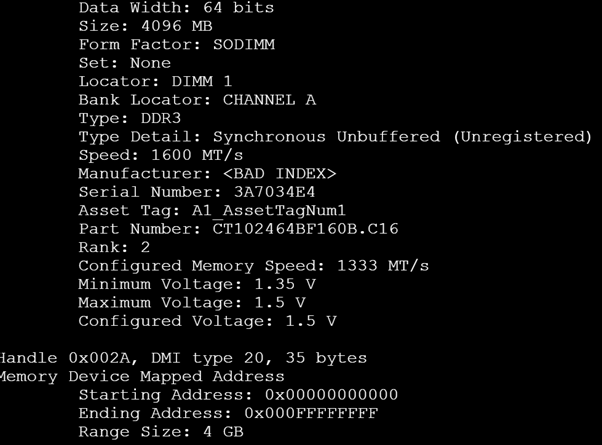

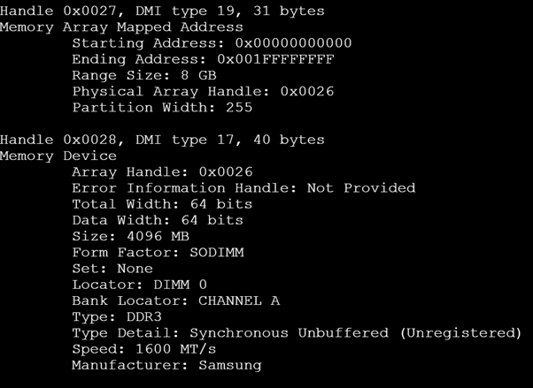

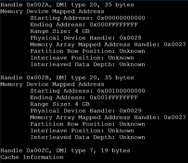

TrueNAS Core or Scale? Is the SoC capable of actually addressing physical memory above 4 GB?
What does dmidecode say about your RAM?

One Samsung and one Crucial DIMM... I'm not saying it shouldn't work, but in the real world some systems are ridiculously picky about DRAM.

Yeah, both models seem to be dual-rank DIMMs, so they really should work.
