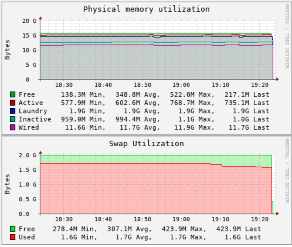

Freenas is using quite a lot of swap, even while there is free memory. I want to understand, what is going on, where should I start?
Update: I should add, I am running freenas 11.1-U5

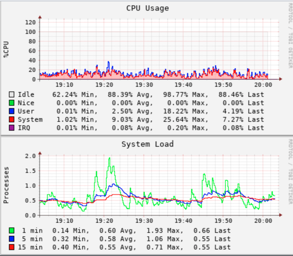

What's the workload?
encbox
Mar 27, 2017
25

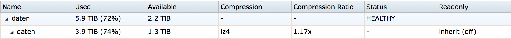

Just 2 people are using this server. Some backup tasks are running nightly to another machine and bhyve is used for a univention corporate server, which also is just used by the same 2 people. I have 3 3TB disks, the volume ist about 75 % full.

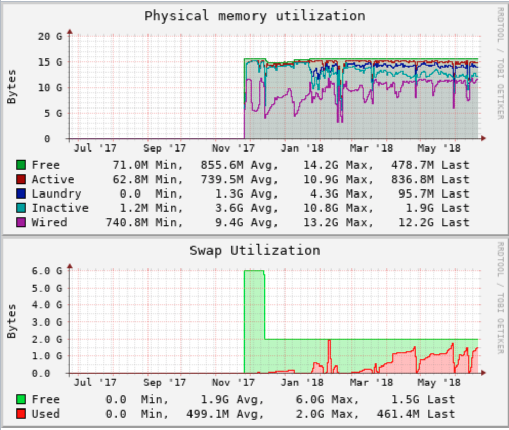

FreeNAS has some tendency since version 9.10 to use swap where common sense would tend to say that swap usage should be not necessary, may be due to a timing problem related to ZFS ARC usage. Using one of the two following workarounds this swap usage possibly can be minimized or even avoided at all.
(1) Reducing excess swap usage substantially using Stux' pagein script periodically
https://forums.freenas.org/index.ph...ny-used-swap-to-prevent-kernel-crashes.46206/
(2) Trying to avoid excess swap usage at all using certain tunables, specifically vm.v_free_target and vfs.zfs.arc_free_target as discussed here
https://forums.freenas.org/index.php?threads/swap-with-9-10.42749/page-5#post-453978
Using 32768 instead of 65536 as values might help to not waste main memory.
Some extra questions to compare your situation with my previous observations: Were you able to keep track of swap usage in more detail in the past? Do the weekly/monthly/yearly graphs give some insight? Are scrubs scheduled on this system? Is the beginning of swap usage (after a reboot, for example) related to scrubs?

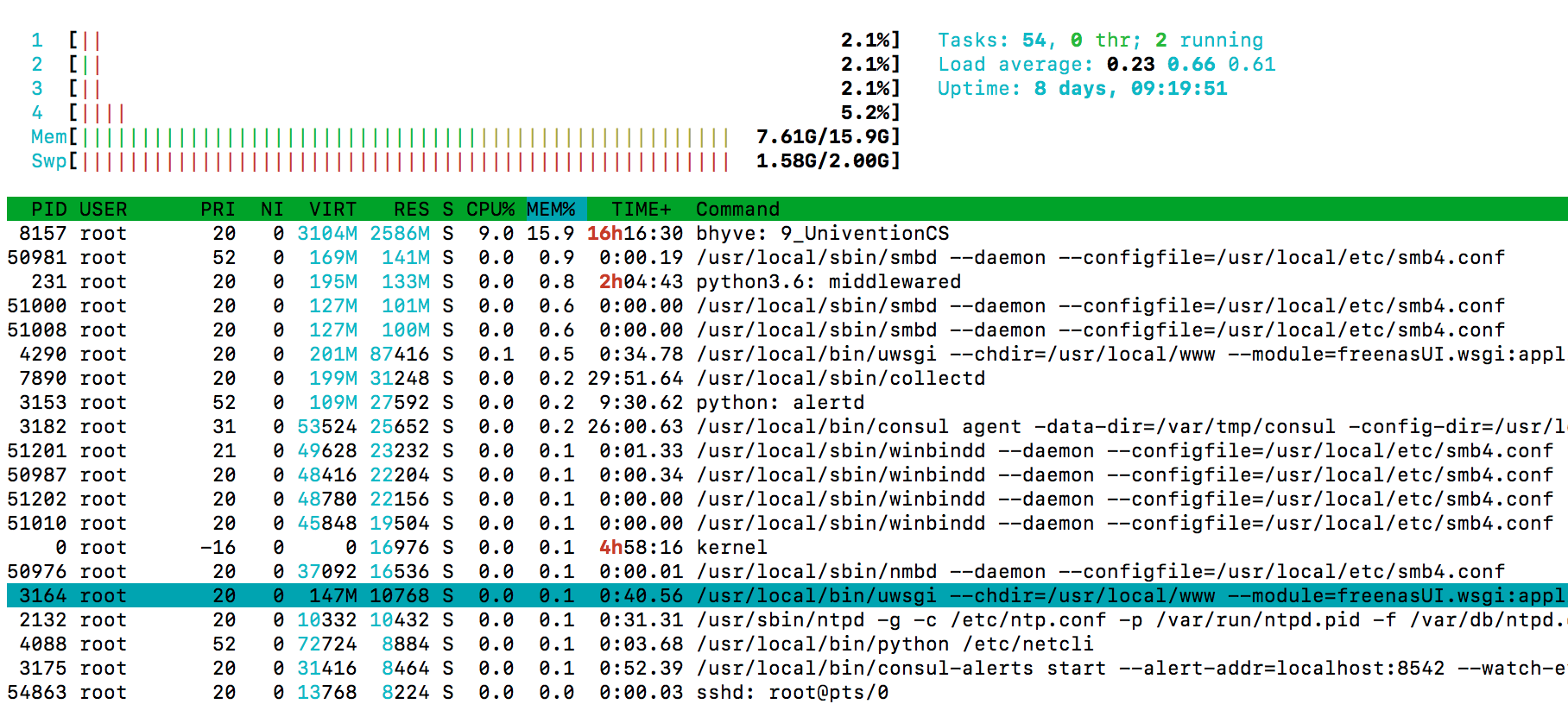

Thanks for all your replies. There is only a jail running with duplicity for nightly backups and bhyve with univention corporate server. Activated services are afp (time machine), ftp, smb, ssh and s.m.a.r.t.
I think its the bhyve since the problem seems to start about the time when I installed ucs.
The swap space continues to grow until
Jun 21 05:43:02 freenas swap_pager_getswapspace(25): failed
Jun 21 05:43:02 freenas swap_pager_getswapspace(32): failed
Jun 21 05:43:02 freenas swap_pager_getswapspace(24): failed
Jun 21 05:43:02 freenas swap_pager_getswapspace(27): failed
Jun 21 05:43:02 freenas swap_pager_getswapspace(30): failed
Jun 21 05:43:02 freenas swap_pager_getswapspace(20): failed
then I usually reboot and it works for a while. Yesterday I started to give only 2GB to the bhyve instead of 3GB in hope that theres more memory for freenas.
