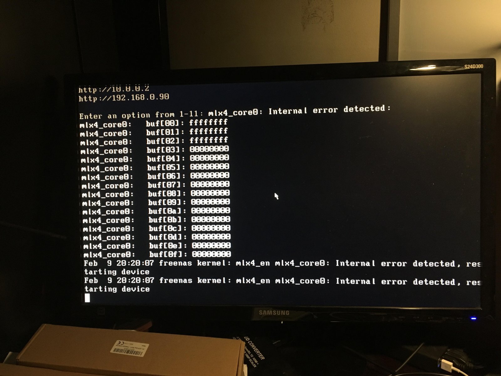

Hi all,
I have aquired a Melanox ConnectX-3 infiniband card that I want to setup on a freeNAS build.
I am using a HP Microserver for which the PCIe version is 2.0. The card is 3.0.
The driver loads at startup, but at a certain point the system crashes.
I have decided to try other opensource OS to figure out if there was any incompatibility and so far it is running well.
Could someone help me figuring out how to make the adapter work?

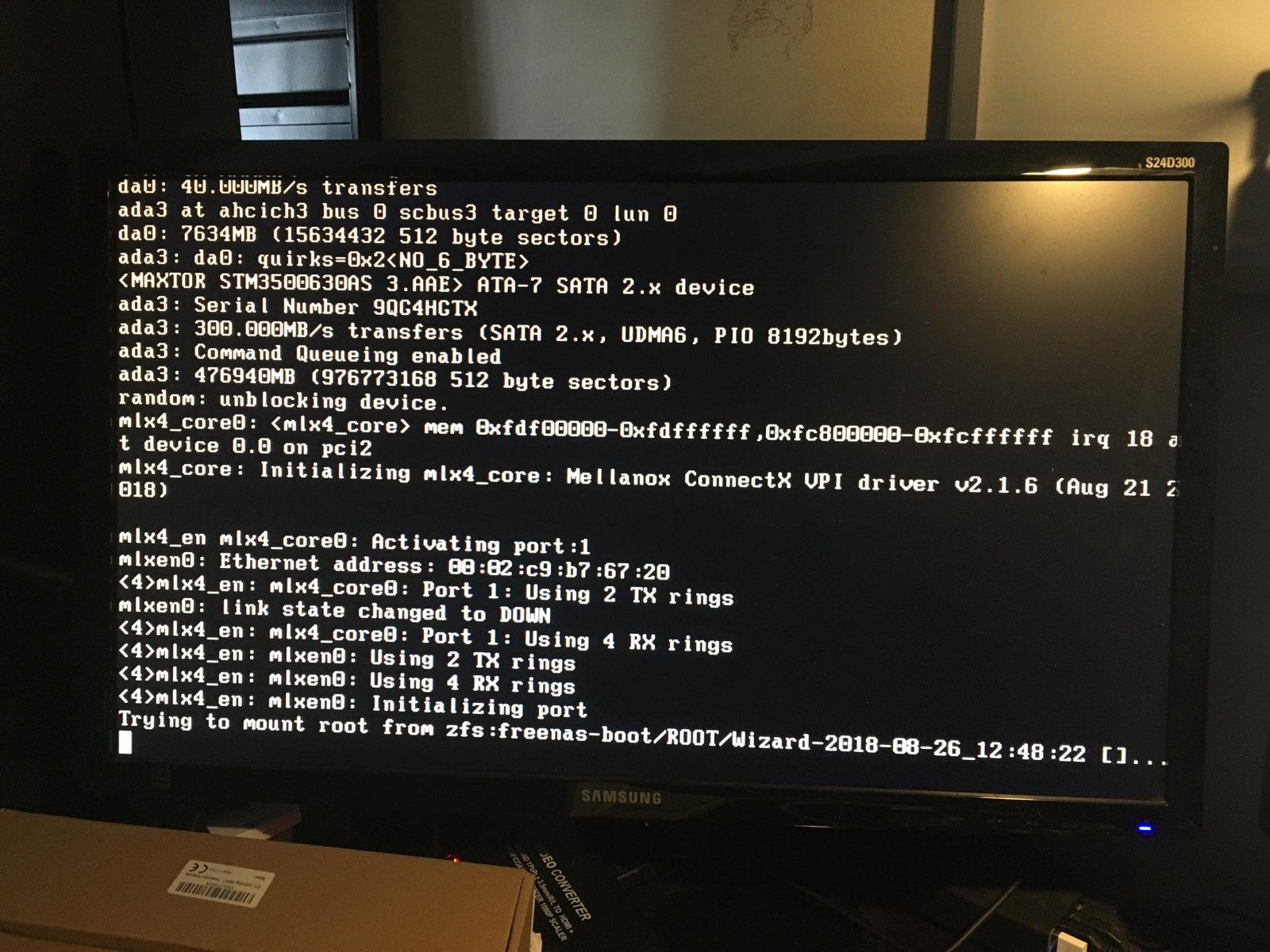

I tried Ubuntu Studio and the I was able to use the card.
My Setup is:
HP Microserver Gen 7
16GB of ECC Ram
HP BMC board
4 x 500GB disks with 2 redundant discs.
Melanox ConnectX-3 infiniband card.

Miguel Nunes
May 6, 2016
52
My Setup is:
16GB of ECC Ram
HP BMC board
