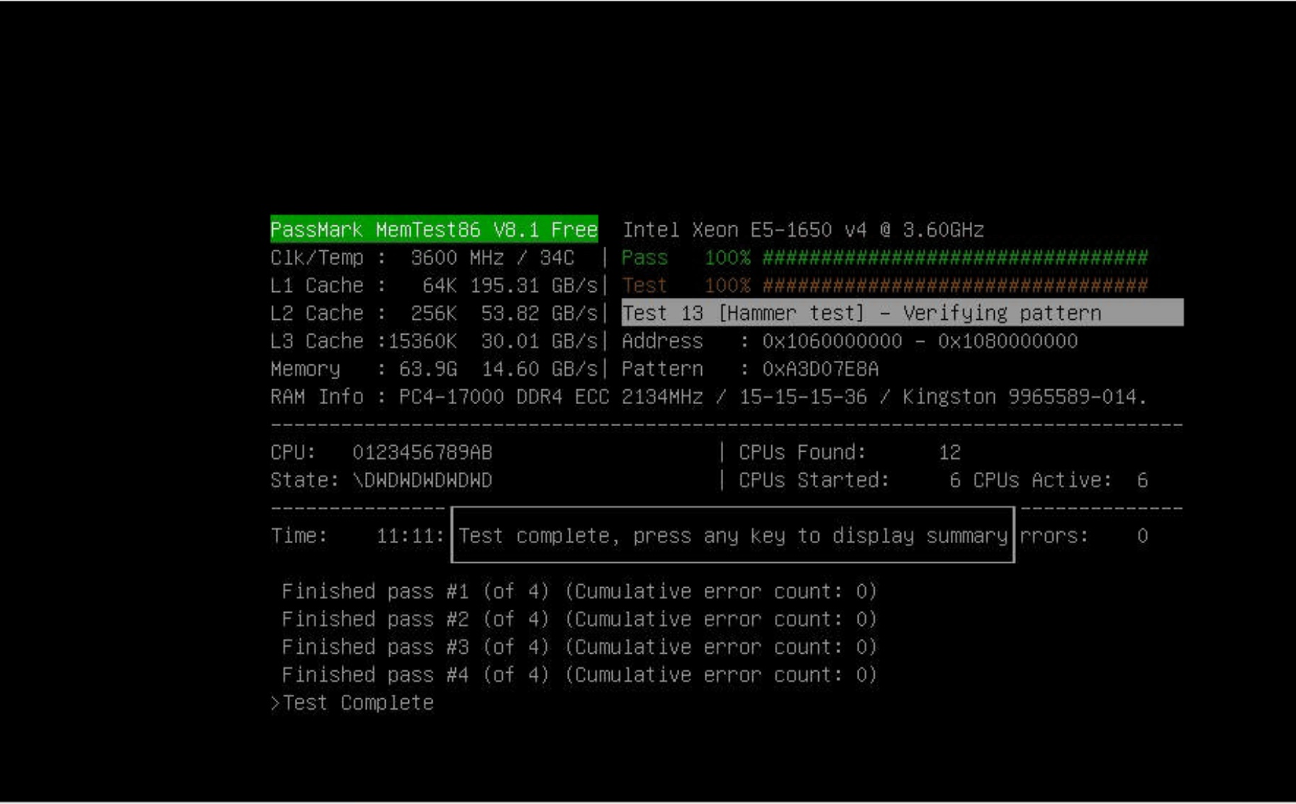

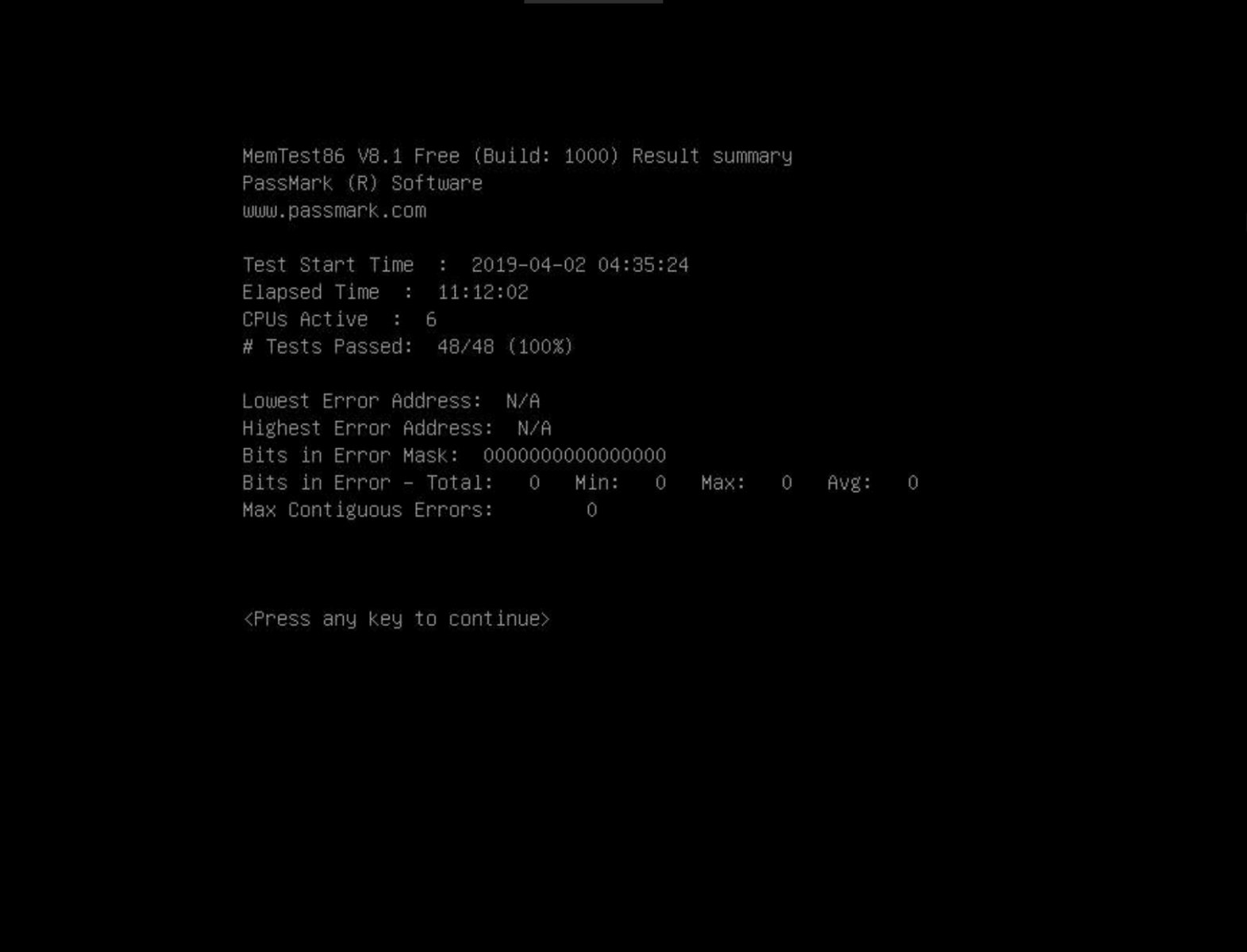

I am running the UEFI version now. Letting it run four passes overnight. I did not select or make configuration changes to Memtest, it just started running. Will report back what I find. Thank you for helping me out!
Nacman
Jul 23, 2018
11
I have ran 4 passes of Memtest and no errors. Not sure if I needed to change any defaults, but it didn’t report errors. Too strange.
