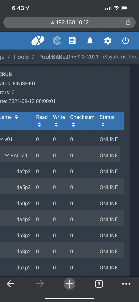

Joining this thread as I am in the same boat… my RiadZ2 6 disk config is abysmal in performance… hitting a max of roughly 220MB/s for write speeds and around 300MB/s for reads on my 10G network :(. I have a 7 disk Raidz1 pool (I know not apples to apples) on another server that gets 2X those speeds.. so trying to figure out this question myself ;)

It's the vDev's. You only have 6 drives, so your RAIDz2 is one vDev. When you write to it, it behaves as if you're writing to a single disk. All the drives perform the I/O in lockstep, and it's not acknowledged as complete until the slowest drive returns success. The RAIDz1 pool likely has two vDev's and issues IOPS in round-robin between them. It will issue I/O to the first vDev, and then move to the second and issue more, hop back to the first, etc... In order to have two vDev's in RAIDz2 you have to meet the fault tolerance requirement for each vDev, so you'd need 8 drives (and could suffer 2 failures in each vDev).
My RaidZ1 pool is one vdev, all 7 disks in one.. no mirroring or striping of vdevs going on. But yeah, wasn’t planning on trying raidz2 with two vdevs, was gonna try 2 raidz1 vdevs, which only needs 6 disks.

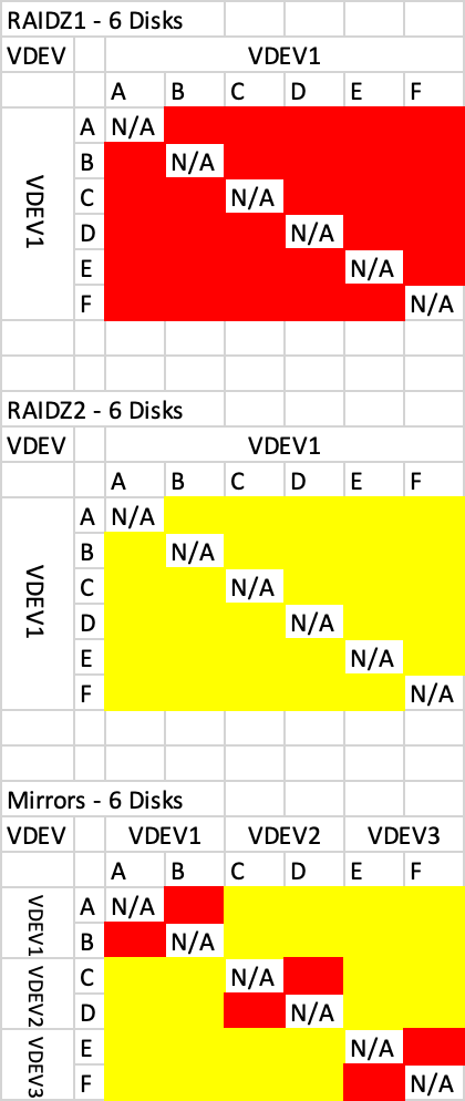

Be aware that in RAIDZ, heavy load is placed on the remaining disks when resilvering (which can take a long time with larger disks ... over 2Tb as a guide), which could land you in the situation of a second failed disk... if that happens, consider this:
Yellow cells represent Pool is degraded, Red cells indicate Pool is dead (i.e. you can't get any data from it at all)
The choice is yours on the risks of the approach.
For Mirrors, you lose half your capacity to redundancy... some folks see that as too much.
For RAIDZ2, you lose 2 disks to parity, so more disks is better value for capacity, but performance (as discussed in the other thread) isn't necessarily better as you consider wider VDEVs (at very least, there's no linear link to wider=more throughput... and the recommended maximum width is 12)
For mirrors, you can get more IOPS for every additional VDEV you add (and you can add them as you go... if maximum IOPS isn't your highest objective... if it is, you need to erase and re-populate the pool to balance the contents on the new and old VDEVs).
