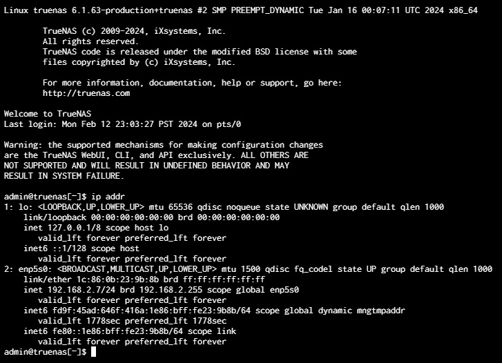

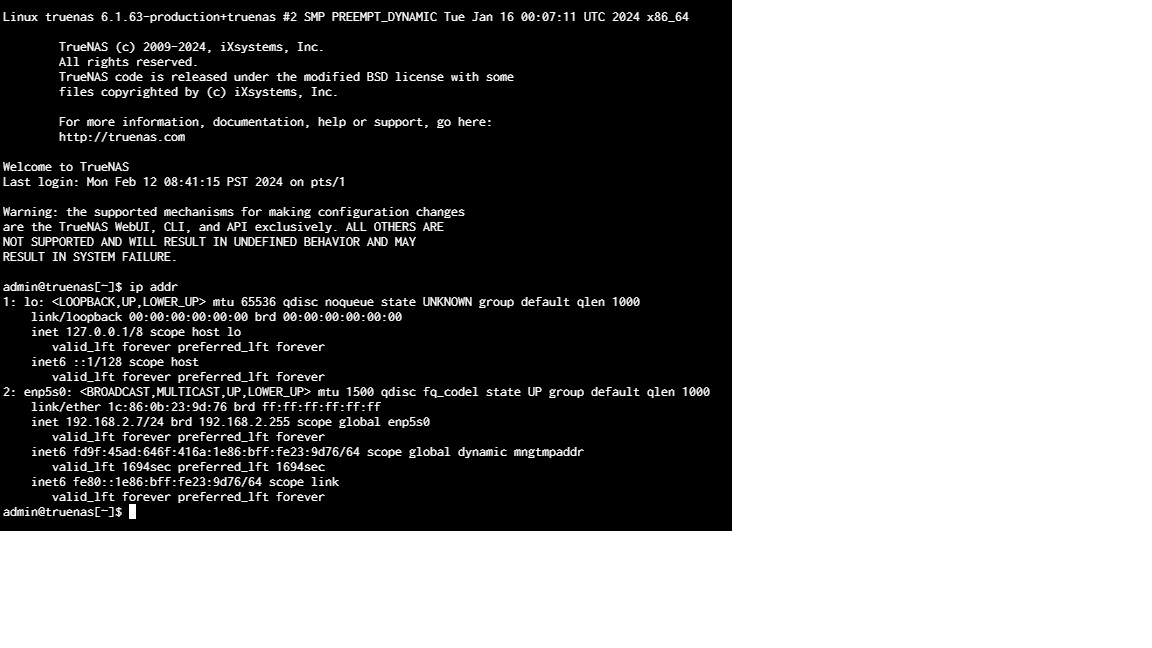

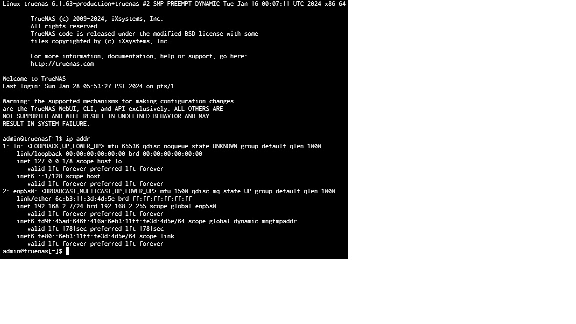

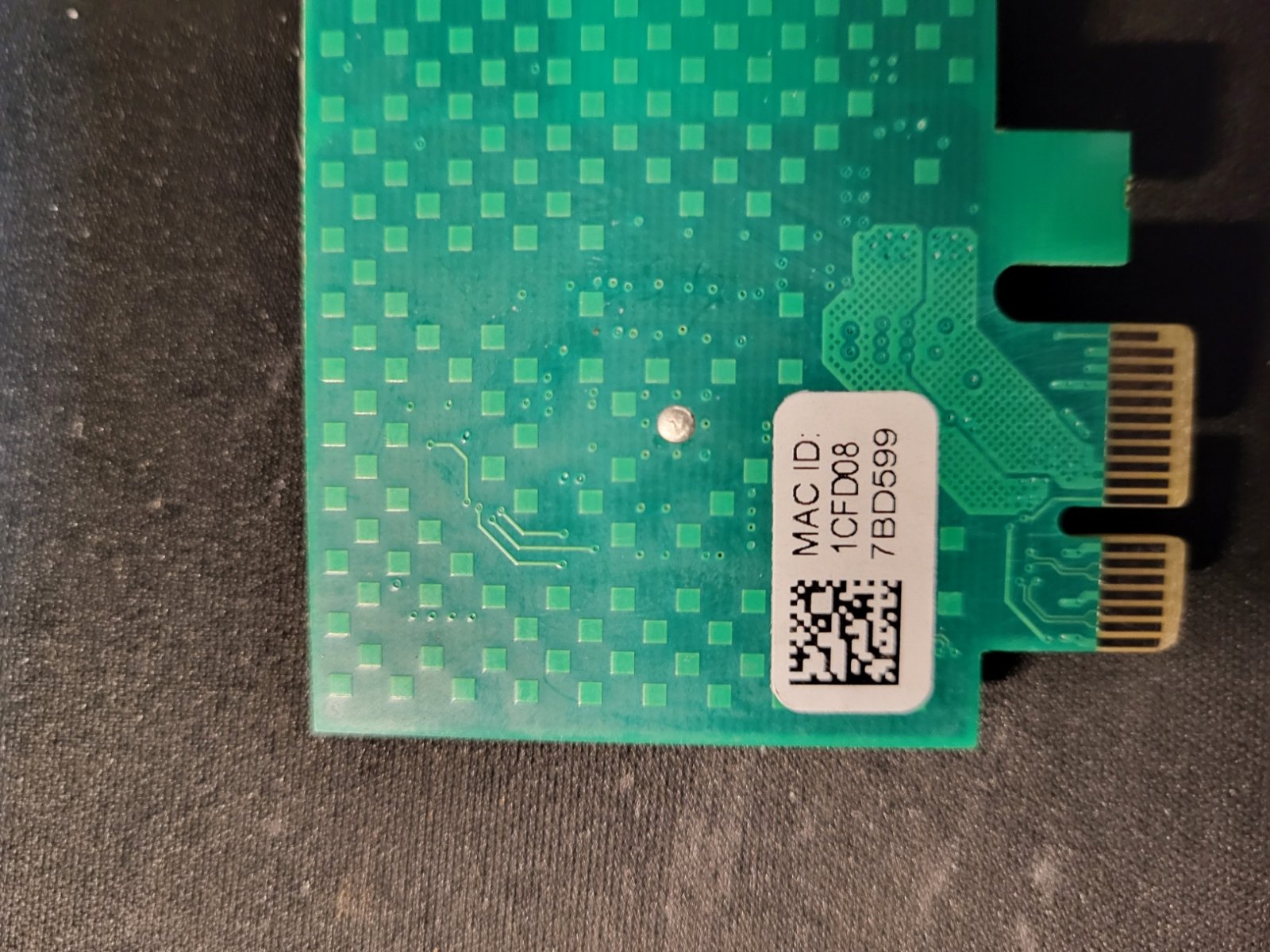

here are some pictures
First Truenas Console
Second Unraid Console
Third MAC on NIC

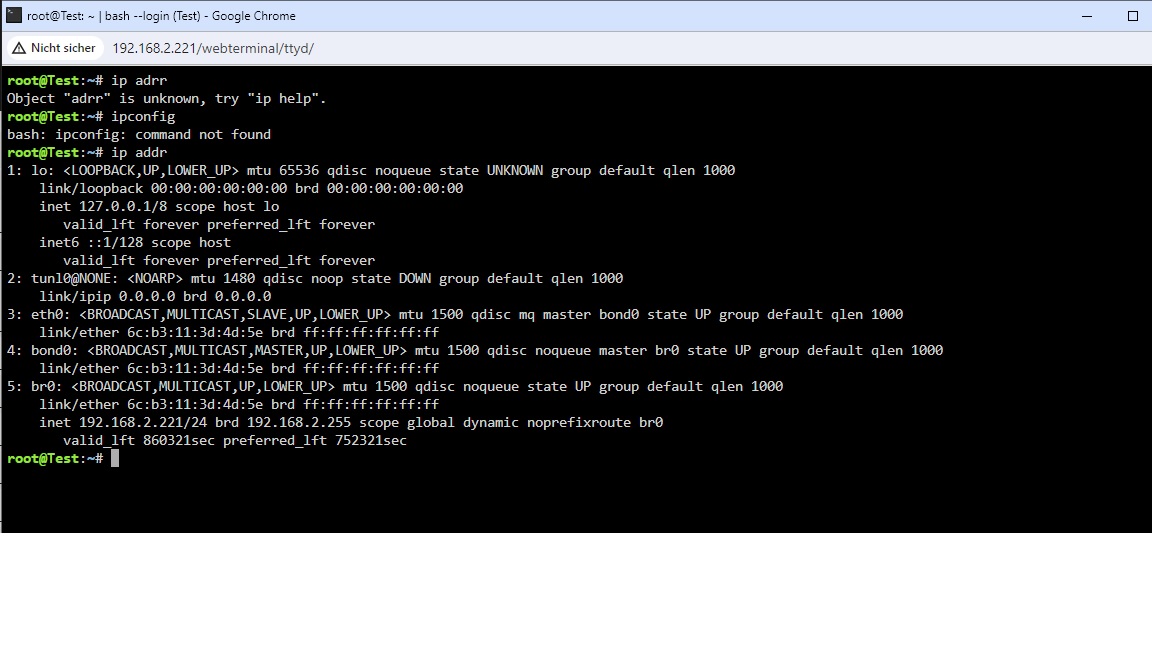

Hip hip hooray, now it works.
