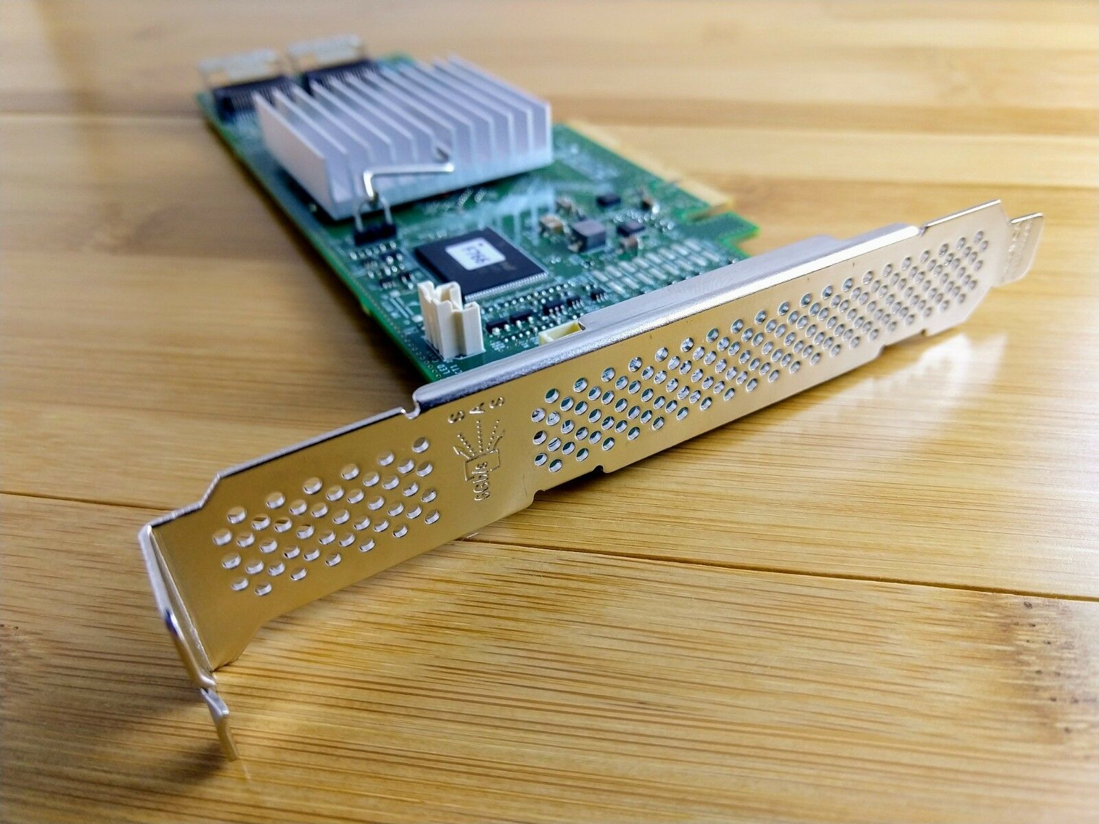

That seller goes to the trouble of replacing the Dell factory bracket with a vented one:
He also fully tests every card when he flashes the firmware.
Here is a link to the video of it: https://www.youtube.com/watch?v=wWJNr7W6DK8
This is the same guy that figured out how to recover a bricked H310 mini card and posted a video of it:
https://www.youtube.com/watch?v=koyVehVIXA8
I wouldn't hesitate to buy from this seller.
