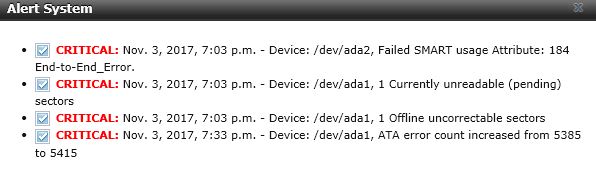

Today iSCSI connection was lost. Checked FreeNAS, get the following error message. New to FreeNAS, please give me a hand on troubleshooting steps to bring back the hard drive if possible.
- unreadable (pending) sectors
- online correctable sectors
- ATA error count increase from 5385 to 5415

Yes, that guide doesn't deal with any diagnosis steps - sorry.
Looks like you have problems on two drives, ada1 and ada2.
Suggest you run smart tests on each and post the results in code tags for review by the many experts here - smartctl -a /dev/adax

Here is the Smart Test result for ada1 / ada2. Please help to understand what is the issue. Thanks,

This isn't my specialty, but both drives look to be running hot, both have reallocated sector counts and ada1 has current pending and offline uncorrectable counts.
ada12 (?) has the "failing now" End-to-end error - I don't know anything about that one.
Hopefully someone more conversant can jump in here with comment.

Rotation Rate:	7200 rpm
Device is:		In smartctl database [for details use: -P show]
ATA Version is:   ATA8-ACS T13/1699-D revision 4
SATA Version is:  SATA 2.6, 3.0 Gb/s
Local Time is:	Fri Nov  3 20:36:59 2017 EDT
SMART support is: Enabled
See vendor-specific Attribute list for marginal Attributes.

SMART Attributes Data Structure revision number: 10
ID# ATTRIBUTE_NAME		  FLAG	 VALUE WORST THRESH TYPE	  UPDATED  WHEN_FAILED RAW_VALUE
  1 Raw_Read_Error_Rate	 0x000f   118   099   006	Pre-fail  Always	   -	   181549753
  3 Spin_Up_Time			0x0003   100   096   000	Pre-fail  Always	   -	   0
  4 Start_Stop_Count		0x0032   099   099   020	Old_age   Always	   -	   1037
  5 Reallocated_Sector_Ct   0x0033   100   100   036	Pre-fail  Always	   -	   2
  7 Seek_Error_Rate		 0x000f   079   060   030	Pre-fail  Always	   -	   91654799
  9 Power_On_Hours		  0x0032   091   091   000	Old_age   Always	   -	   8554
 10 Spin_Retry_Count		0x0013   100   100   097	Pre-fail  Always	   -	   3
 12 Power_Cycle_Count	   0x0032   099   099   020	Old_age   Always	   -	   1369
184 End-to-End_Error		0x0032   093   093   099	Old_age   Always   FAILING_NOW 7
187 Reported_Uncorrect	  0x0032   100   100   000	Old_age   Always	   -	   0
188 Command_Timeout		 0x0032   100   099   000	Old_age   Always	   -	   62
189 High_Fly_Writes		 0x003a   001   001   000	Old_age   Always	   -	   173
190 Airflow_Temperature_Cel 0x0022   055   046   045	Old_age   Always	   -	   45 (Min/Max 41/46)
194 Temperature_Celsius	 0x0022   045   054   000	Old_age   Always	   -	   45 (0 11 0 0 0)
195 Hardware_ECC_Recovered  0x001a   028   021   000	Old_age   Always	   -	   181549753
197 Current_Pending_Sector  0x0012   100   100   000	Old_age   Always	   -	   0
198 Offline_Uncorrectable   0x0010   100   100   000	Old_age   Offline	  -	   0
199 UDMA_CRC_Error_Count	0x003e   200   200   000	Old_age   Always	   -	   0
240 Head_Flying_Hours	   0x0000   100   253   000	Old_age   Offline	  -	   7524 (33 91 0)
241 Total_LBAs_Written	  0x0000   100   253   000	Old_age   Offline	  -	   3935769474
242 Total_LBAs_Read		 0x0000   100   253   000	Old_age   Offline	  -	   3452445201

[root@freenas111] ~#

iSCSI is back now. Will migrate data out of ada1. Should I low-level format the drive and put it in use again. Just wonder if I can RMA the drive? What is the HDD RMA policy?
No especially because you have no way of doing so and doing so would be absolutely pointless anyway.

ada1 is toast, replace it. You also need to check the status of ada2. ada12 is supect as well from the "failing now" in the smart output.
Are you actually running scheduled smart tests every hour? And a scrub every day is a bit excessive.
Your drives are running very hot, you need to address that. The Seagate 7200.11 drives are total crap and known to be failure prone.

Thanks, Regarding 184 Error Message on ada2, what steps can I follow? Should I open a new post on that?

Not sure how others feel about it but if I had a smart attribute that says "failing now" I would replace the drive.

ada1 has dangerous firmware SD15. You should replace that drive because it is failing, but if you have any others, you should upgrade the firmware.

Thanks! Is SD1A the latest firmware. However to upgrade? Google it but can't find one showing detail steps.

Did you check the two Seagate page links in the ada1 smart report? The second link has the detailed upgrade instructions, the first should tell you/confirm if SD1A is the latest.
Do you have ada2 AND ada12 with End-to-End "Failing Now"? Your first post had the Alert System pasting showing ada2, the smart tests you made had ada12 but not ada2.
