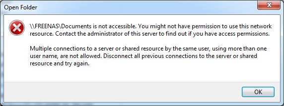

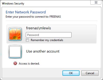

Currently, when I attempt to access the 'Documents' share, Windows asks me to login and presents me with the Windows Security dialog [refer attached screenshot]. Entering my password does not appear to work as I am, shortly after, presented with the Open Folder dialog box [refer attached picture]. However, accessing the 'Media' share is not a problem and I haven't been requested to login since the share was first created and users assigned.

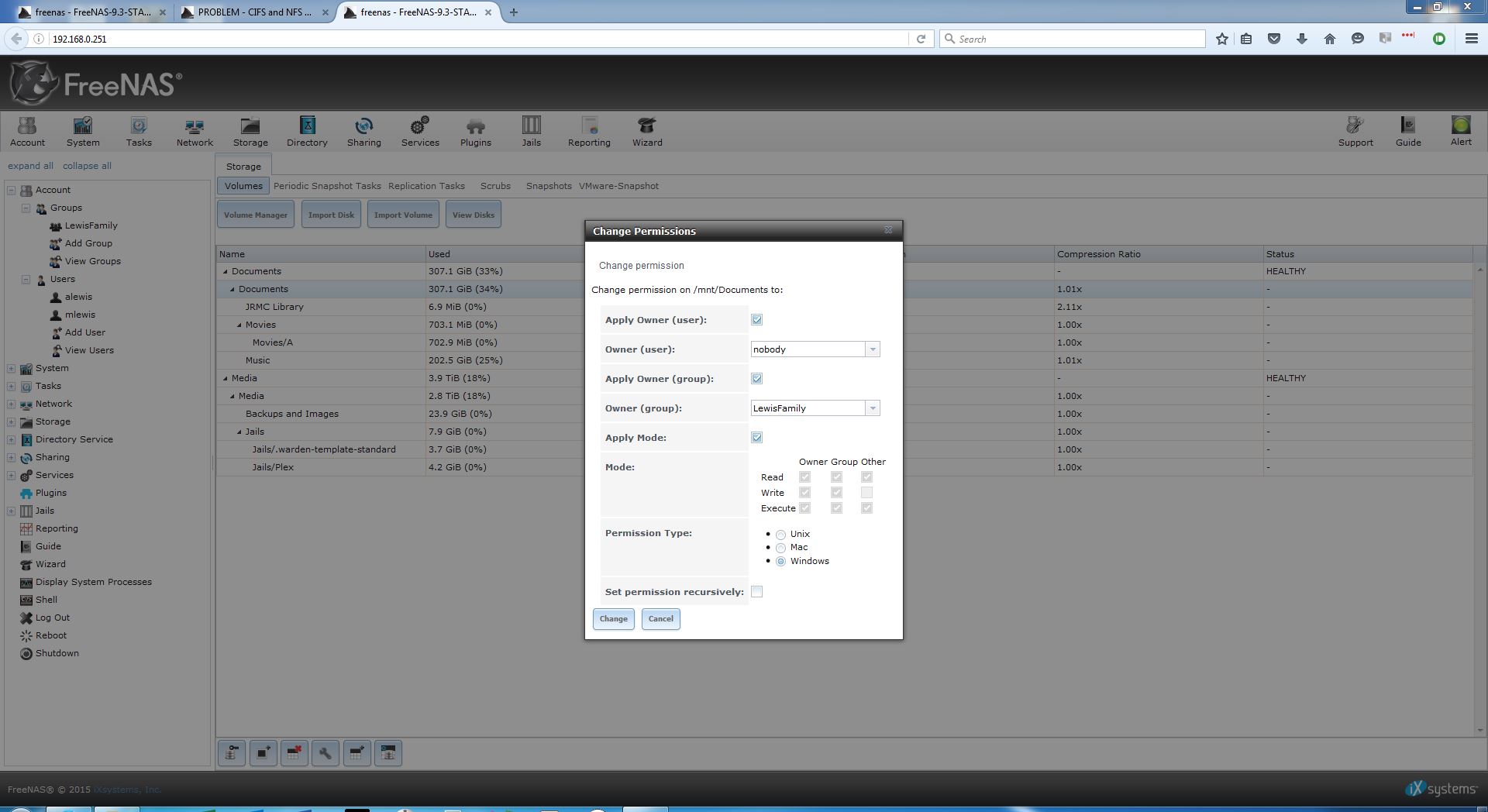

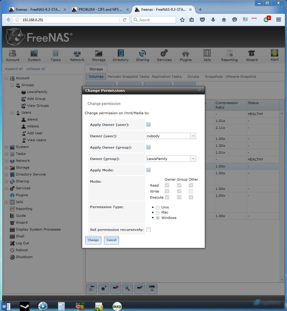

The security settings, within FreeNAS, for both shares are the same [screenshots of both are attached]. I based them on M0nkey's YouTube video on setting permissions in YouTube [https://www.youtube.com/watch?v=RxggaE935PM]
I've read what the Open Folder dialog box has to say about multiple connections but I'm not sure how to put this into context nor check if it is what is causing the issue.
