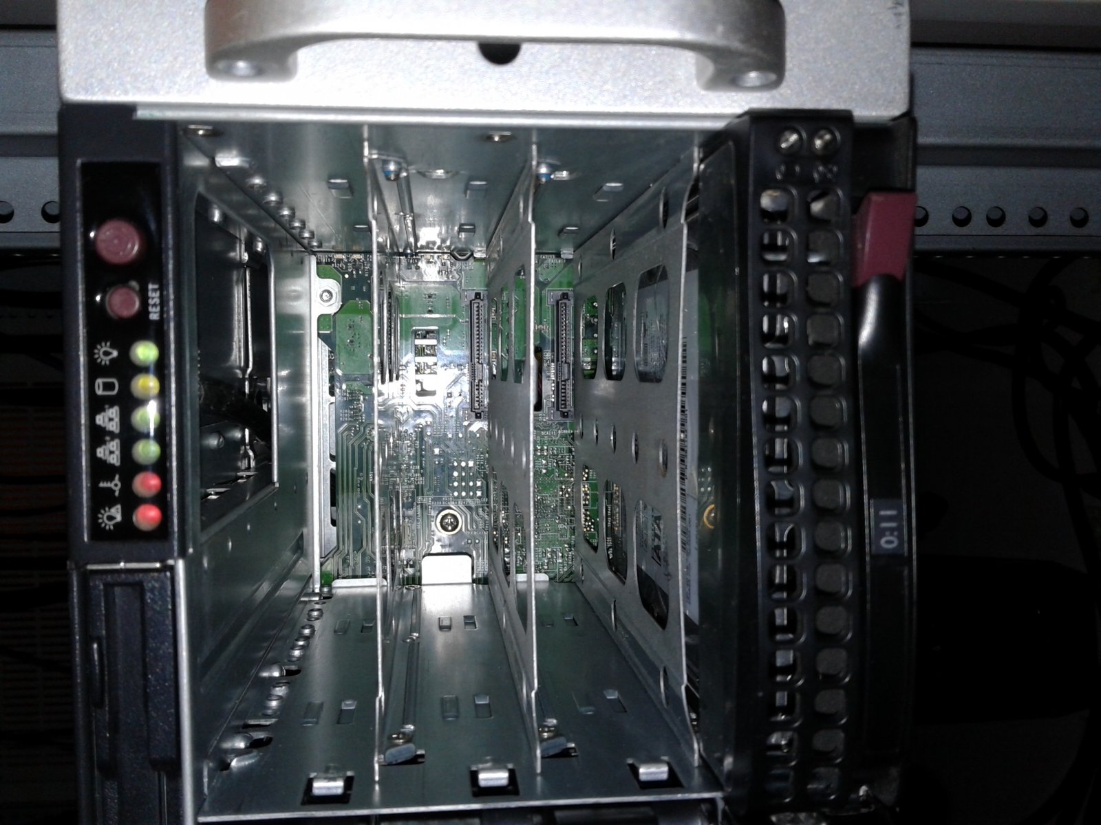

My phone (5MP) is the only tool I have to provide pictures of this type of thing. If the quality of this shot is good enough, I can provide a few others.
I don't have the tools to provide the precise measurements you would require.

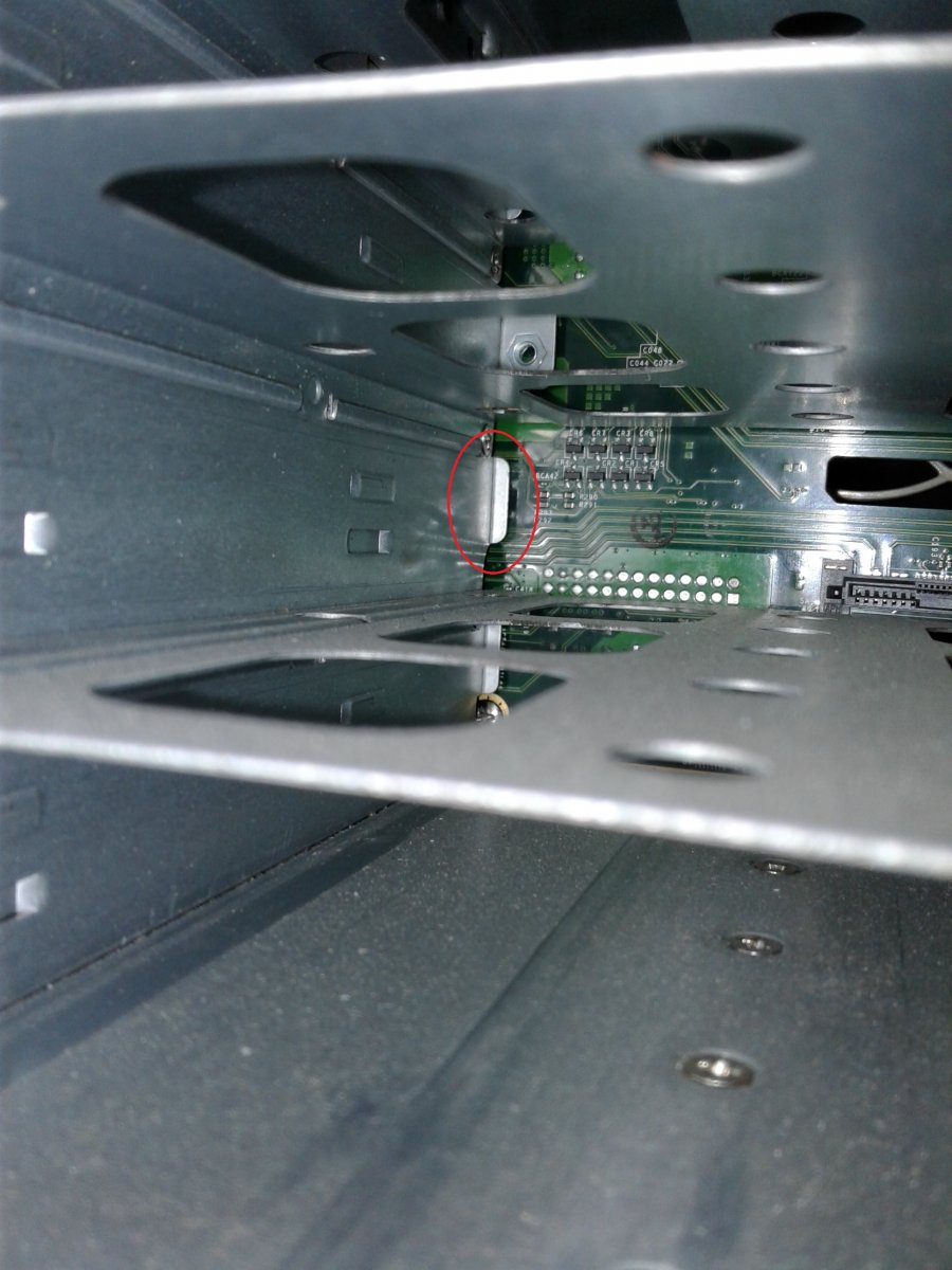

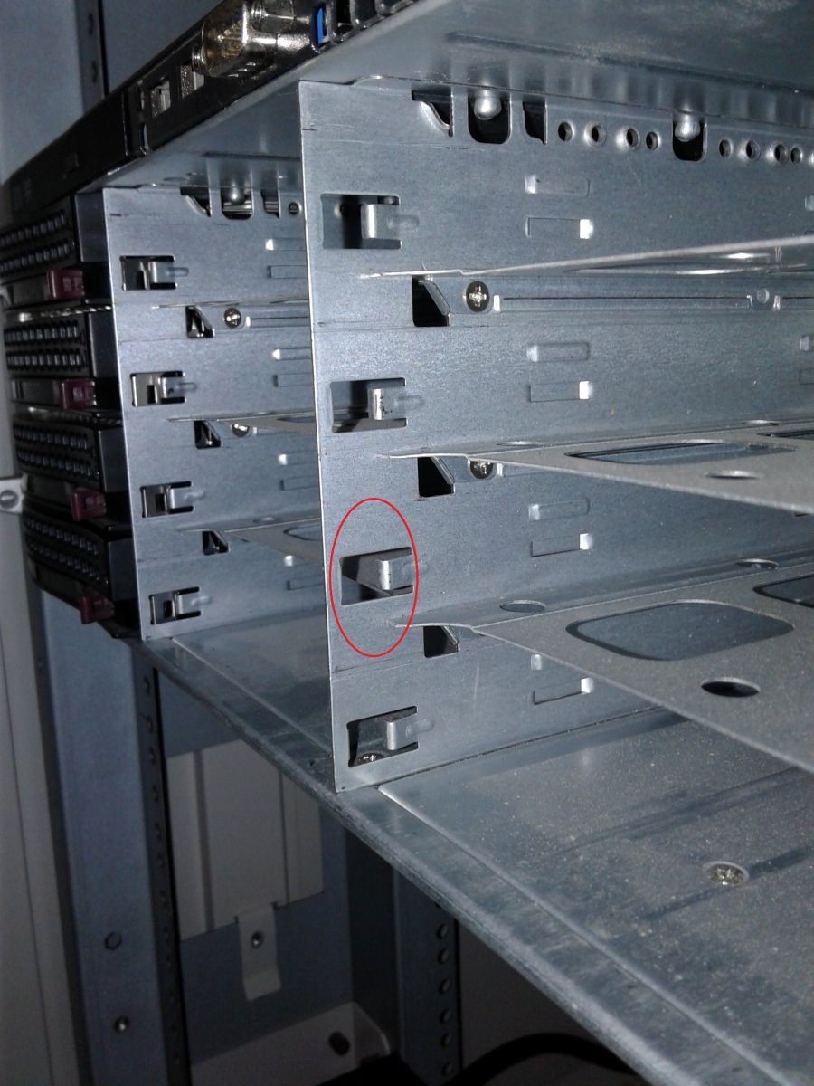

I don't know if this piece in the circle provides a "stop" function, but it appears to...

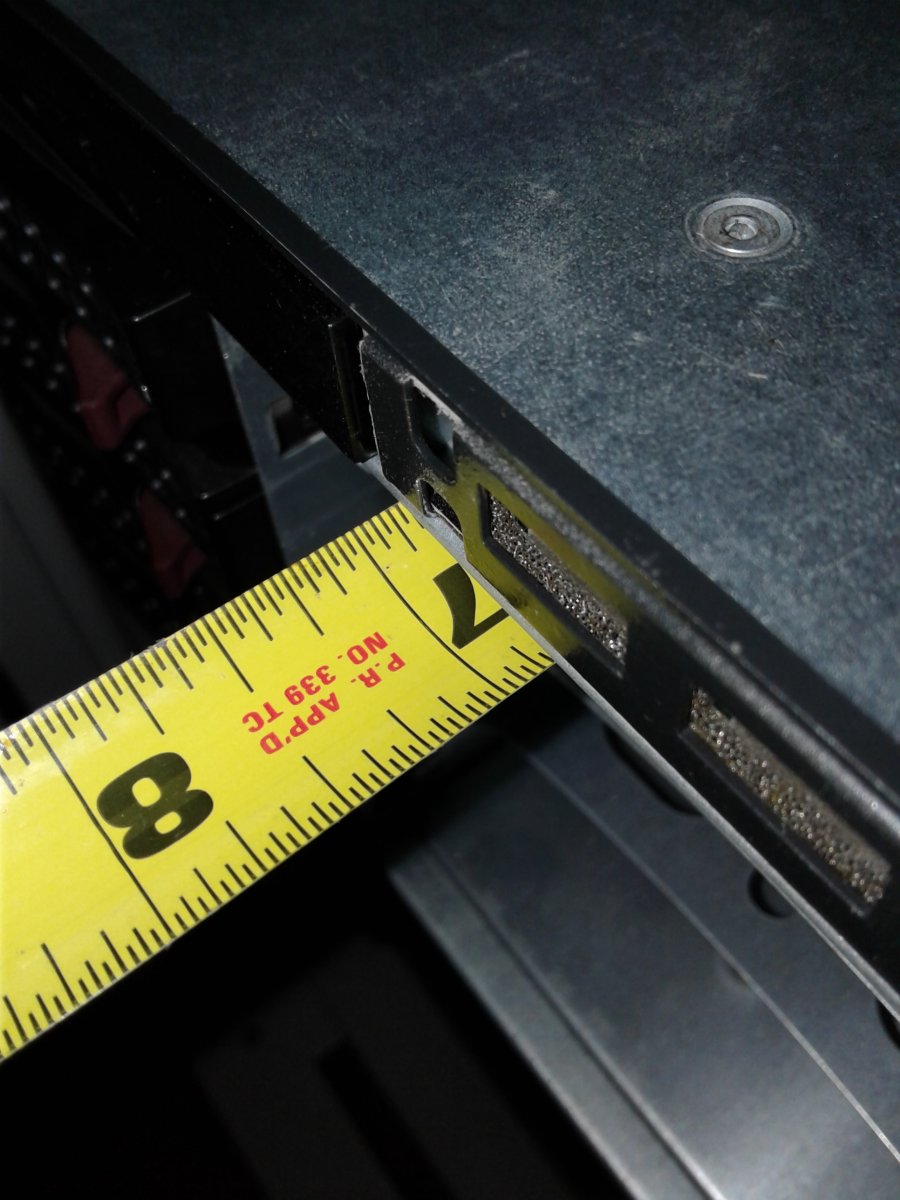

this last one is from the PCB of the backplane to the front of the bay, again, not very accurate...
