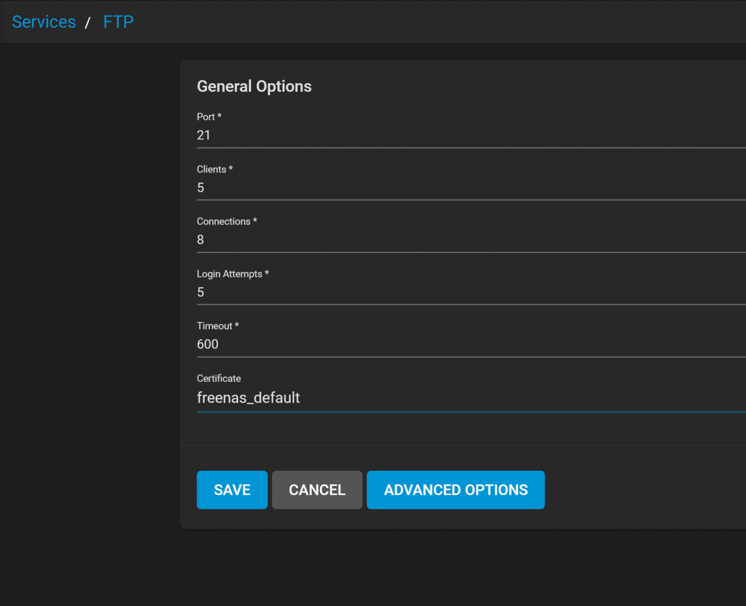

Fresh install: TrueNAS-13.0-U5.2
Problem: can't connect to FTP via public IPv4 address (same as TN interface) and even local intranet 10.x IPv4. I reset the pw a few times, nothing.
FTP service is enabled and port 21.

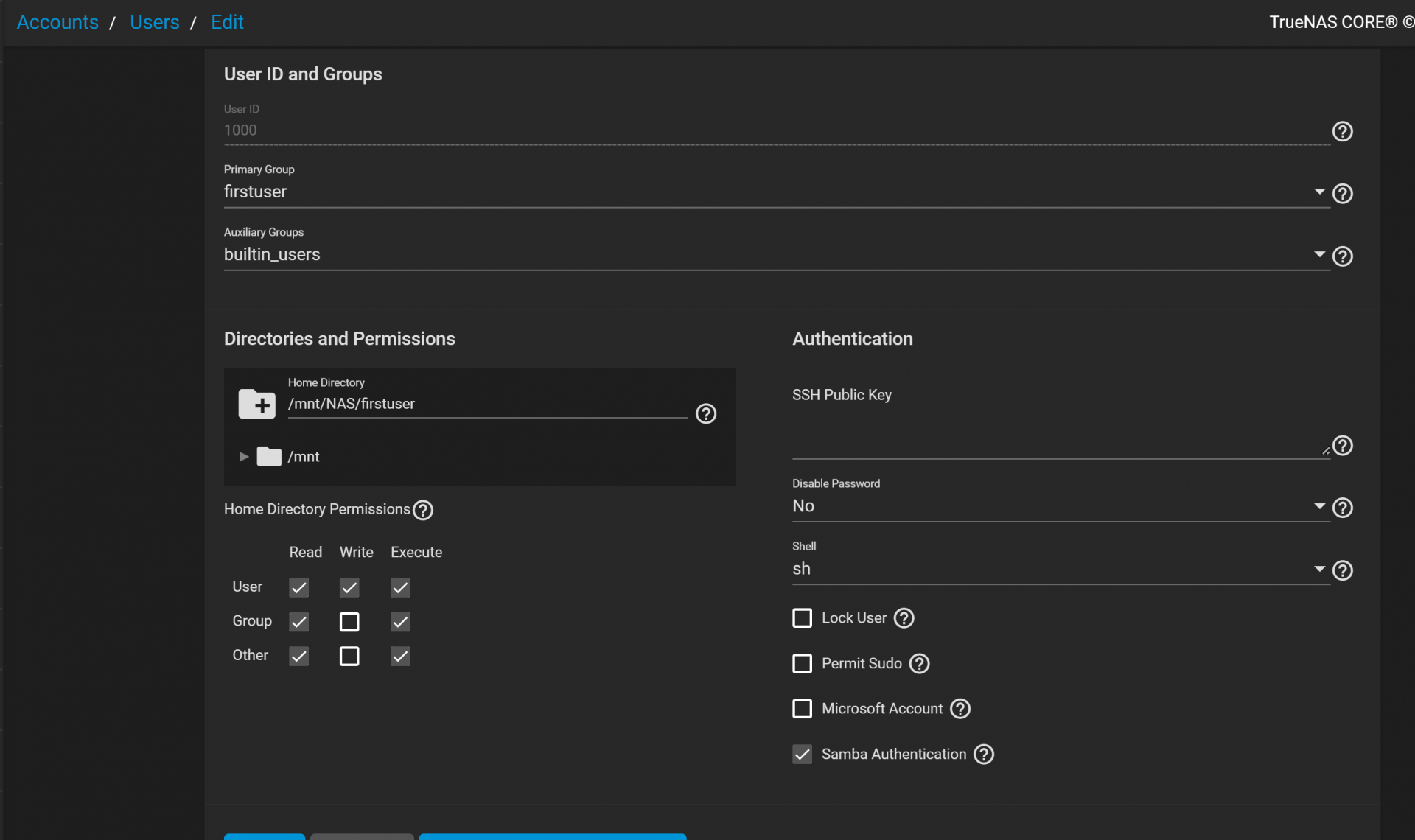

Username Info
GID:1000
Home directory:/mnt/NAS/firstuser
Shell:/bin/sh
Email:user@domain.com
Password Disabled:false
Lock User:false
Permit Sudo:false
Microsoft Account:false
Samba Authentication:true
FTP Port 21
Command:    USER firstuser
Response:    331 Password required for firstuser
Command:    PASS ************
Response:    530 Login incorrect.
Error:    Critical error: Could not connect to server

Does the home directory exist?

Yes.
root@truenas[/mnt/NAS]# ls -lh
total 17
drwxr-xr-x  2 firstuser  firstuser     9B Aug  9 16:48 firstuser

root@truenas[~]# service ftpd start
Cannot 'start' ftpd. Set ftpd_enable to YES in /etc/rc.conf or use 'onestart' instead of 'start'.
root@truenas[~]# service ftpd onerestart
ftpd not running? (check /var/run/ftpd.pid).
Starting ftpd.
root@truenas[~]# service ftpd onestatus
ftpd is not running.
root@truenas[~]#

I have no idea for your fundamental problem with the login, sorry. Only help I can offer: service ftpd start is not how you do that on TrueNAS. Use the UI and the Services menu to start, stop, enable, disable, ... services.
OK, reading from the top again - your FTP client cannot even connect. So what does netstat -na | grep LISTEN say with the service enabled?

Figured out ftp issue. Had to enable "allow local user login" in the hidden advanced section.
