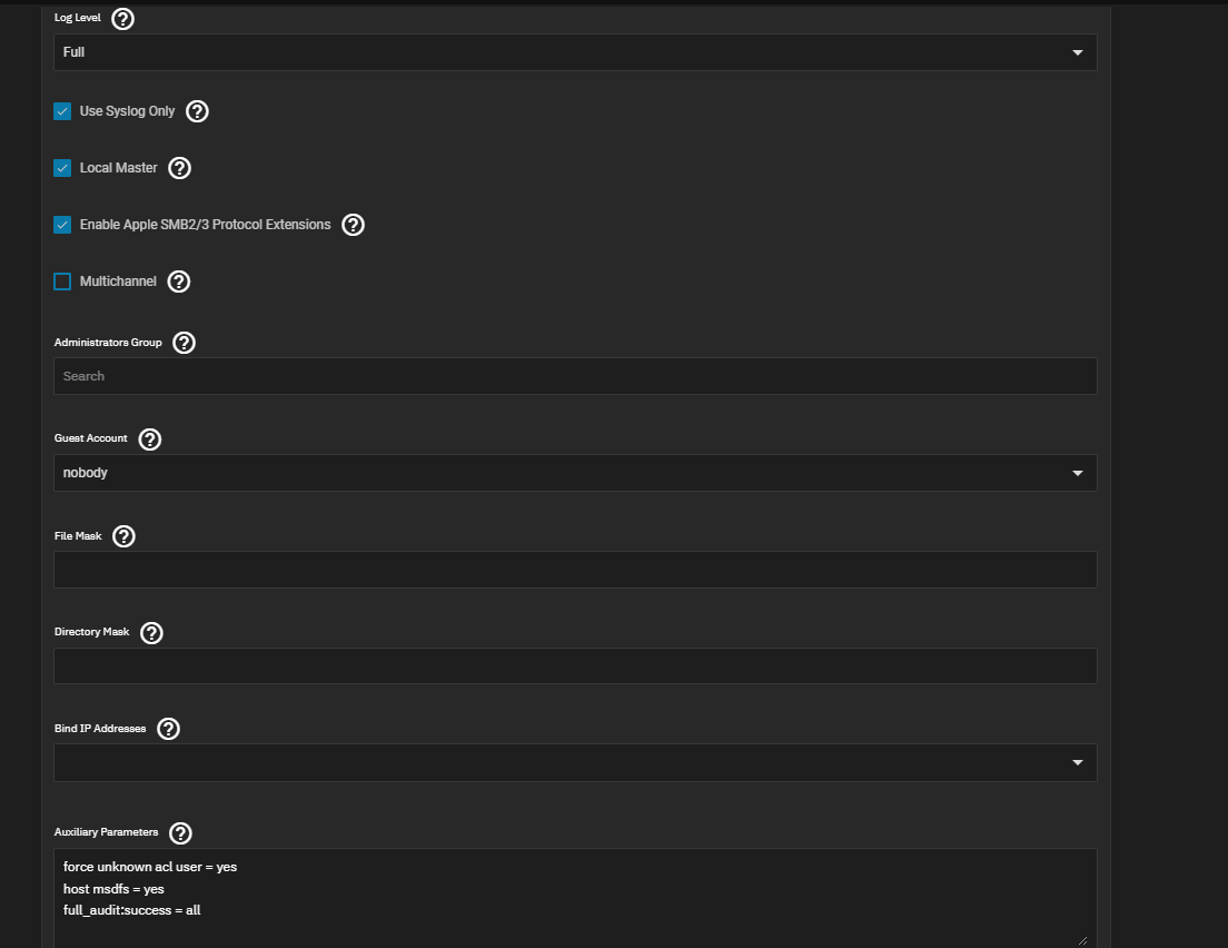

We are using TrueNAS-SCALE-22.12.3.1
I am sending our syslogs to a Wazuh server.
currently in System Settings > Services > SMB > Advanced Options I have log level set to FULL and checked off Use Syslog Only.
When I reference the logs either in wazuh or FreeNas, all I see are open and close on files, which is dandy, but I am looking for more, like when permissions are changed on a file. (We access the shares from Windows computers) I have tested Deleting a file, copying a file, changing Permissions on a file and the only show up as Open and Close in logs. they look like this

I have seen a lot of talk of using full_audit as a auxiliary parameter, which I have tried.
Currently I have set
full_audit:success = all
under Aux param for SMB.
For the Syslog logging I have "info" selected as the log level.
any help would be greatly appreciated!
thank you

I have made if further in the logging. On my share aux parameters I have
vfs objects = full_audit zfsacl
full_audit:failure = connect
on my SMB aux params I have
If I go to /var/log/ and tail the syslog file I get info like this

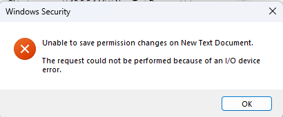

WHICH IS WHAT I WANT, so made a little progress.....but now if I go to edit ACL's on a file I get an error below
If I take away the
from the share aux parameters I am able to change the acls on the file....any help would really be appreciated.
Again we use TrueNas Scale.
