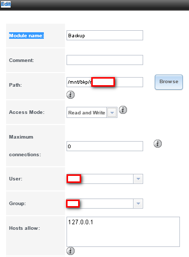

I used the local rsync --daemon and the Module was not changed.
I recreated the Module and Task with no avail.
Manual and scheduled start do not change the output.

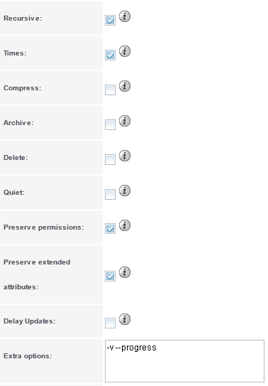

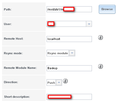

Rsync Task configuration:
Module configuration screenshots below.
The user is is the same and has all rights (well didnt changed them after the update)
Source and destination are different -encrypted- volumes on the same system and are mounted.
What has changed with the rsyncd (conf) and how to fix this?

I solved the local backup by enabling the rsync service under the service tab and added --address=127.0.0.1 to Auxiliary parameters.
