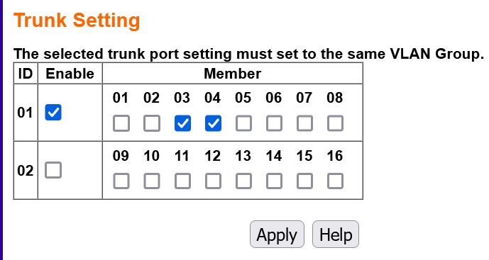

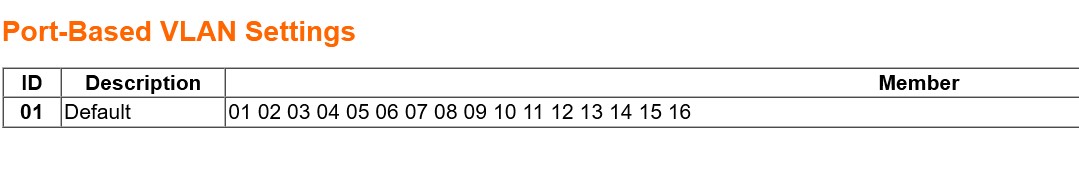

Has anybody setup link aggregation on GS716v1 successfully. Followings are the steps that I have taken:
1. I have installed the firmware (V1.1.8).
2. all ports are included in VLAN setting
3. Included ports 3,4 in VLAN group ID 1 in trucking setting.
4. In TureNAS 13.1.U1 I create the link aggregation.
I get a error message to check the cables or the switch. I have checked the cables. I think I have done all that needs to be done on the switch side.
Do you see what I have done wrong?
