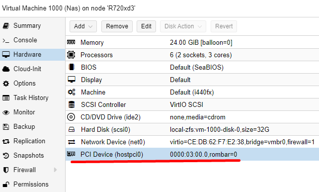

I will try to explain better here.
I have been using PCI passthrough. I have passthrough totally the raid controller "H710 D1 MINI (it mode)" with all the drivers attached to the TrueNAS on VM.
So, only the TrueNAS VM can have access to h710 d1 mini (it mode), i can'T uset with another VM.
I have not using at all hardware raid on the server.
I made flash on "H710 D1 MINI" with this tutorial https://fohdeesha.com/docs/perc.html and with this card "LSI 9207-4i4e SAS HBA 6Gbps PCI-E 3.0 P20 IT Mode for ZFS FreeNAS unRAID" i use in order to boot with Proxmox.
