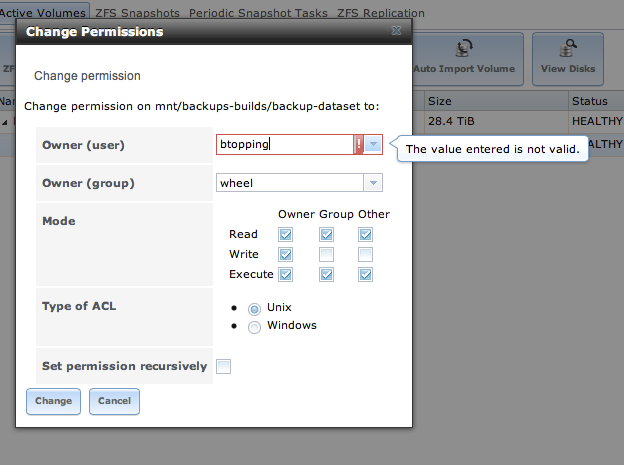

Still not able to assign an AD user to a share though. See attached image, owner (user) value from AD states that "The value entered is not valid". I also tried from the command line to see if there was any better luck with wbinfo, but after five minutes, I get this:

How can I adjust the size of the cache? The underlying disk that the system is installed on is 200GB, so there shouldn't be an issue.

Right now you can't and there is a feature request for that: https://bugs.freenas.org/issues/1177. It wouldn't hurt to add a comment to that thread to let the devs know that this is still an issue and something that is needed for large AD environments. That will bring the ticket back up into the dev queue.
