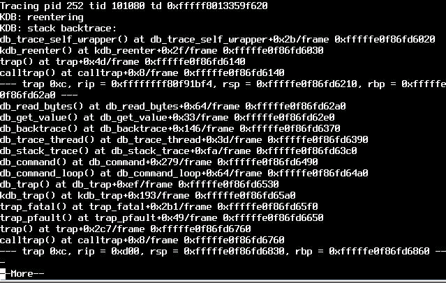

I can't seem to get this box to boot now since doing updates. Prior to this was running 9.10, then did a update about a year ago and we had the same problem. We reverted back to the older version of FreeNAS and everything was working good. Attempted a 11.2 U4 last night and getting the same issue with the screenshot below. I'm not sure where to begin with this. I am going to try and just blow away the installation and start fresh to see where that gets me, but any extra help would be awesome.

Fresh install seems to have issues as well. Seems to always have the issue when doing the networking? Not sure.
Also booting from USB drive, and also brand new disks so not likely the issue. Hardware is as follows:

Showed the BT:
Edit: Tried installing not on USB and same issues.
