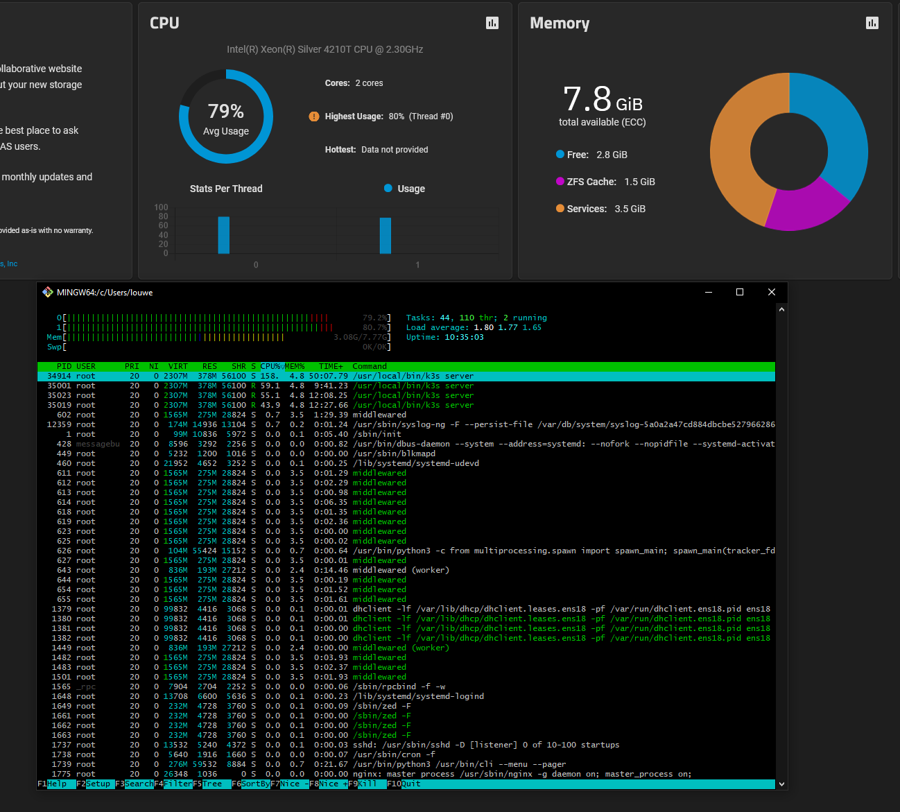

Anyone knows the cause of this? CPU usage is up the wazoo. I suspect it has something to do with the fact that I can't install any SCALE apps also. Any attempt to install comes back with error "Unable to connect to kubernetes cluster". App Catalog shows up just fine though.
May also be worth mentioning that I see these in the logs.

I've tried destroying the ix-applications dataset to no avail.
NOTE: This is just a test VM and I don't have any data on this. Just testing out TrueNAS SCALE apps.

Have you tried under Apps | Settings | Unset pool ?
I just did it and reset the pool. Still getting the error. CPU usage is still up. I haven't rebooted yet just so I can try out stuff that people might suggest here, but that's also an option, though I doubt it will fix my kubernetes error.

Same problem. Upgraded from 13-Core to Bluefin, got a bunch of "k3s server" processes consuming upto 90% of 4C8T Core i7-870 CPU load with no VMs and pool unset.
Is there any solution to stop k3s heating air?
