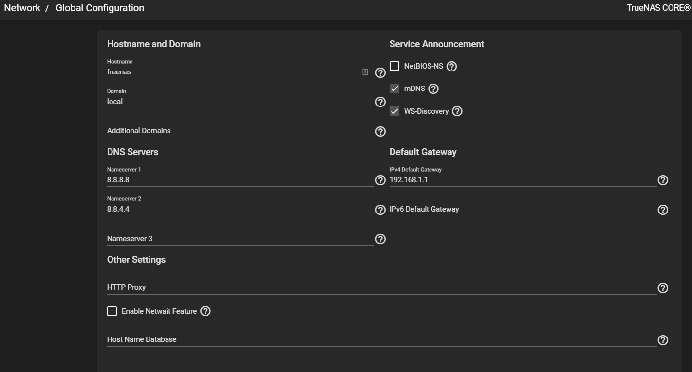

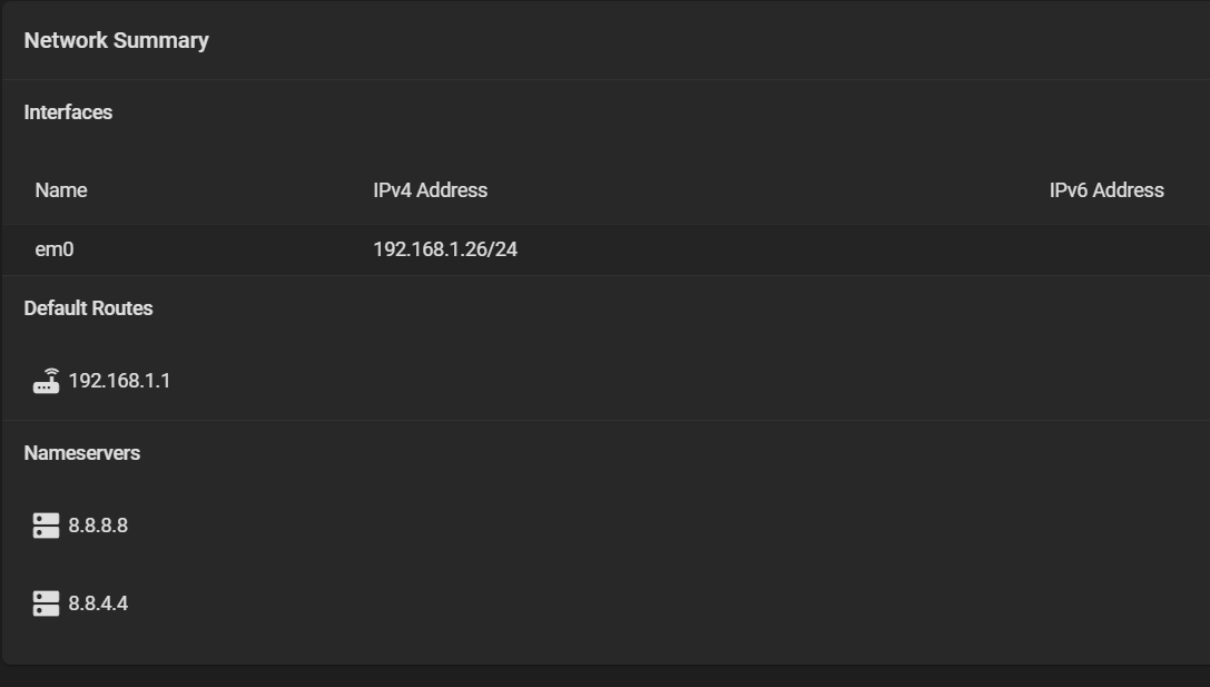

Here's the TrueNAS Network Summary screen:
Here's the Network Global Config screen:
Anyone have any thoughts or suggestions?
