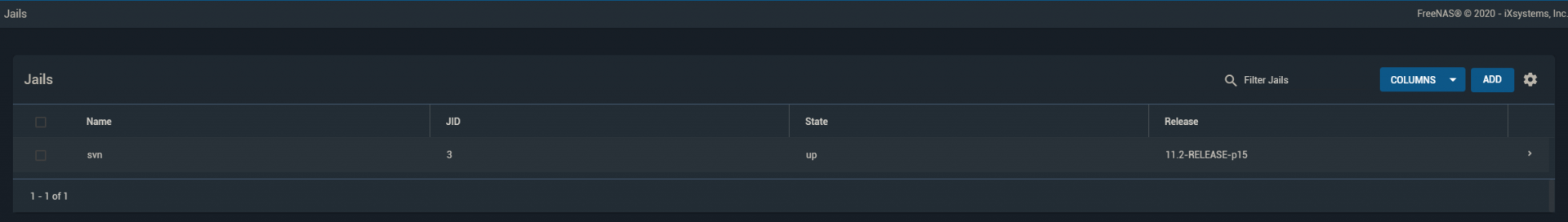

Hello,
I have recently upgraded to 11.3-RELEASE and after that I also updated my single jail (iocage). When I login to jail OS I read
root@svn:~ # uname -a FreeBSD svn 11.3-RELEASE-p5 FreeBSD 11.3-RELEASE-p5 #0 r325575+8ed1cd24b60(HEAD): Mon Jan 27 18:07:23 UTC 2020 root@tnbuild02.tn.ixsystems.com:/freenas-releng/freenas/_BE/objs/freenas-releng/freenas/_BE/os/sys/FreeNAS.amd64 amd64
When I see jails from new GUI I read
11.2-RELEASE-p15
I am not sure if this should be like it is now. I just wanted to be sure that it is not a "bug" of some kind. If it is a kind of bug, I will report that.
Thanks & regards,
Ertan

Run freebsd-version inside your jail; the uname command shows the version from the kernel (FreeNAS host).

freebsd-version does indeed match GUI displayed version.
