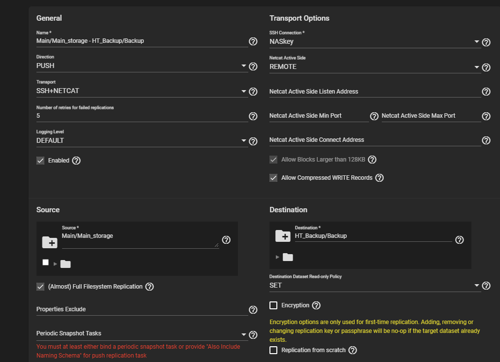

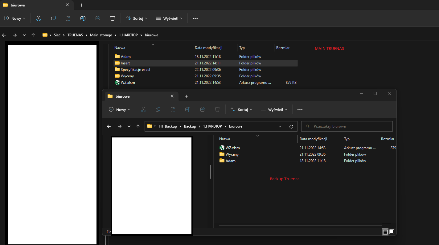

Hi All,
I have 2 Truenas servers: Main(Truenas) and Backup(TrueBackup).
I've scheduled snapshots on Truenas every 15min, and Replication task on TrueBackup every 30 min.
Unfortunately new files are not showing in TrueBackup evern 1 day later.
Below logs from TrueBackup

You made sure the destination dataset on the backup NAS is read-only? You cannot have a replication and mount the destination read/write.
Patrick M. Hausen
Nov 25, 2013
7,776
That's not enough. The destination dataset must not be mounted read/write. The replication works on the block level. As soon as you change anything in the destination dataset it won't get updated anymore, only the snapshots.
You can enforce read-only mode for the destination in the replication task settings. You might have to start over. Or possibly roll back to the latest snapshot after manually setting read-only on the destination.

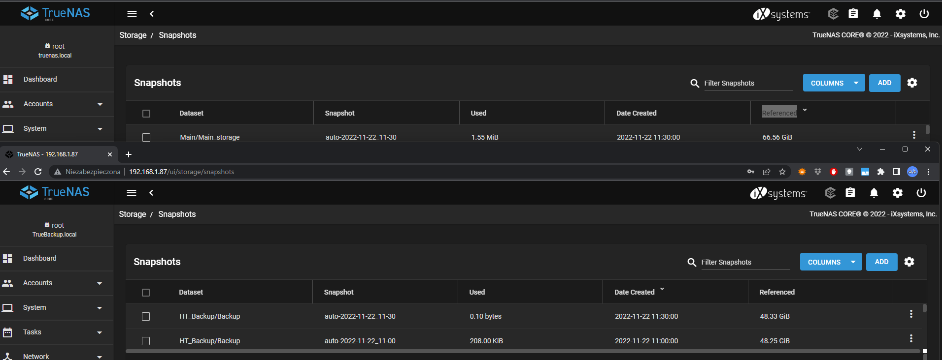

OK still have the problem snapshot on Main Truenas is different than snapshot in TrueBackup:

Then check your replication task schedule, the status, etc.

root@TrueBackup[~]# zfs list -t snap
NAME USED AVAIL REFER MOUNTPOINT
HT_Backup/.system/samba4@wbc-1668582168 120K - 292K -
HT_Backup/.system/samba4@wbc-1668588705 120K - 292K -
HT_Backup/.system/samba4@wbc-1668590904 120K - 292K -
HT_Backup/.system/samba4@wbc-1668598332 120K - 292K -
HT_Backup/.system/samba4@wbc-1668598951 120K - 292K -
HT_Backup/.system/samba4@wbc-1668599098 120K - 292K -
HT_Backup/.system/samba4@wbc-1669039747 120K - 292K -
HT_Backup/Backup@auto-2022-11-15_05-37 0B - 5.16G -
HT_Backup/Backup@auto-2022-11-15_05-38 0B - 5.16G -
HT_Backup/Backup@auto-2022-11-15_06-00 0B - 5.16G -
HT_Backup/Backup@auto-2022-11-15_06-30 0B - 5.16G -
HT_Backup/Backup@auto-2022-11-15_06-45 0B - 5.16G -
HT_Backup/Backup@auto-2022-11-15_07-00 0B - 5.16G -
HT_Backup/Backup@auto-2022-11-15_07-15 0B - 5.16G -
HT_Backup/Backup@auto-2022-11-15_07-30 0B - 5.16G -
HT_Backup/Backup@auto-2022-11-15_07-45 0B - 5.16G -
HT_Backup/Backup@auto-2022-11-15_08-00 0B - 5.16G -
HT_Backup/Backup@auto-2022-11-15_08-15 0B - 5.16G -
HT_Backup/Backup@auto-2022-11-15_08-30 0B - 5.16G -
HT_Backup/Backup@auto-2022-11-17_20-30 0B - 5.17G -
HT_Backup/Backup@auto-2022-11-17_20-45 0B - 5.17G -
HT_Backup/Backup@auto-2022-11-17_21-00 0B - 5.17G -
HT_Backup/Backup@auto-2022-11-17_21-15 0B - 5.17G -
HT_Backup/Backup@auto-2022-11-17_21-30 0B - 5.17G -
HT_Backup/Backup@auto-2022-11-17_21-45 0B - 5.17G -
HT_Backup/Backup@auto-2022-11-17_22-00 0B - 5.17G -
HT_Backup/Backup@auto-2022-11-17_22-15 0B - 5.17G -
HT_Backup/Backup@auto-2022-11-17_22-30 0B - 5.17G -
HT_Backup/Backup@auto-2022-11-17_22-45 88K - 5.17G -
HT_Backup/Backup@auto-2022-11-17_23-00 4.39M - 5.17G -
HT_Backup/Backup@auto-2022-11-18_06-00 0B - 47.2G -
HT_Backup/Backup@auto-2022-11-18_06-15 0B - 47.2G -
HT_Backup/Backup@auto-2022-11-18_06-30 0B - 47.2G -
HT_Backup/Backup@auto-2022-11-20_22-30 0B - 47.2G -
HT_Backup/Backup@auto-2022-11-20_22-45 0B - 47.2G -
HT_Backup/Backup@auto-2022-11-20_23-00 0B - 47.2G -
HT_Backup/Backup@auto-2022-11-21_13-30 4.48M - 47.5G -
HT_Backup/Backup@auto-2022-11-21_14-00 144K - 48.2G -
HT_Backup/Backup@auto-2022-11-21_14-30 88K - 48.2G -
HT_Backup/Backup@auto-2022-11-21_15-00 0B - 48.2G -
HT_Backup/Backup@auto-2022-11-21_15-30 0B - 48.2G -
HT_Backup/Backup@auto-2022-11-21_16-00 0B - 48.2G -
HT_Backup/Backup@auto-2022-11-21_16-30 0B - 48.2G -
HT_Backup/Backup@auto-2022-11-21_17-00 0B - 48.2G -
HT_Backup/Backup@auto-2022-11-21_17-30 0B - 48.2G -
HT_Backup/Backup@auto-2022-11-21_18-00 0B - 48.2G -
HT_Backup/Backup@auto-2022-11-21_18-30 0B - 48.2G -
HT_Backup/Backup@auto-2022-11-21_19-00 0B - 48.2G -
HT_Backup/Backup@auto-2022-11-21_19-30 0B - 48.2G -
HT_Backup/Backup@auto-2022-11-21_20-00 192K - 48.2G -
HT_Backup/Backup@auto-2022-11-21_20-30 192K - 48.2G -
HT_Backup/Backup@auto-2022-11-21_21-00 0B - 48.2G -
HT_Backup/Backup@auto-2022-11-21_21-30 0B - 48.2G -
HT_Backup/Backup@auto-2022-11-21_22-00 0B - 48.2G -
HT_Backup/Backup@auto-2022-11-21_22-30 0B - 48.2G -
HT_Backup/Backup@auto-2022-11-21_23-00 0B - 48.2G -
HT_Backup/Backup@auto-2022-11-22_06-00 0B - 48.2G -
HT_Backup/Backup@auto-2022-11-22_06-30 192K - 48.2G -
HT_Backup/Backup@auto-2022-11-22_07-00 0B - 48.2G -
HT_Backup/Backup@auto-2022-11-22_07-30 0B - 48.2G -
HT_Backup/Backup@auto-2022-11-22_08-00 412K - 48.2G -
HT_Backup/Backup@auto-2022-11-22_08-30 144K - 48.2G -
HT_Backup/Backup@auto-2022-11-22_09-00 152K - 48.2G -
HT_Backup/Backup@auto-2022-11-22_09-30 224K - 48.2G -
HT_Backup/Backup@auto-2022-11-22_10-00 0B - 48.2G -
HT_Backup/Backup@auto-2022-11-22_10-30
Patrick M. Hausen
Nov 25, 2013
7,776
This looks completely erratic on the backup side. Can you try push instead?
Patrick M. Hausen
Nov 25, 2013
7,776
The push task must be configured on the main TrueNAS ...
Main NAS - Snapshot - Push Task --> Backup NAS.
Patrick M. Hausen
Nov 25, 2013
7,776
Sorry, never seen that with my systems. Out of ideas. Open an issue in JIRA.
