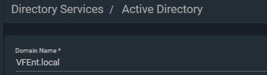

3) Due to unique worldwide circumstances (COVID) I moved this box from an AD environment (work) to my home to update hardware and load some data

Initially I had issues with AD based logins, I'm not sure what the cache duration was/is or how FreeNAS deals with things, but it was easy enough to add a local account. Once I did so, everything worked as expected. The system using the two internal drives will write at theoretical Ethernet speeds (~115MB/sec - no jumbo frames on the home NW) and was performing well. I backed up around 600GB of data to it and loaded another 100GB of files over SMB with no issues. I did however make a few changes to my home network and noticed that AT&T is pushing a "search domain" down through their boundary device.

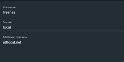

4) I've tried to set the SMB bind interface, but all I see in the settings is a "--".

I believe this is a network or FreeNAS configuration problem. I think this for two reasons, first I had everything working really well at home using a local account. Logins were quick and transfers maintained high theoretical speeds. In updating my NW equipment I'm now getting a pushed "domain" from AT&T Gig fiber of attlocal.net. This seems to impact Zeroconf and possibly other dynamic browsing on my network. Prior to this I'd run "domain less" with a .local being the preferred and working method of connection. This would certainly be a candidate for the very slow presentation of the login information under Windows. As for the copy speed, as you can see it's FULL speed once it resumes, but I believe the initial high speed is a misleading windows trick on outbound queue or something and that the stalled connection is really at the beginning of the file creation on the FreeNAS system. If browsing wasn't lightening fast with directories containing hundreds/thousands of files I'd be convinced this was the case.

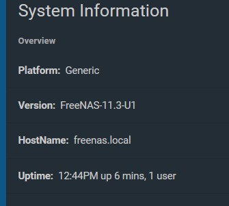

On day two, I backed up the config, placed one S3700 drive in the system, loaded the same version of FreeNAS that was on the previous boot media FreeNAS-11.3-U1, rebooted and restored the config. Everything came up fine on the system to include the web interface and the emby jail. Emby is running fine and at full speed. CPU utilization hovers between 0-6% while doing some modest and light testing. Memory consumption under testing never exceeds 8GB with services at about 1.7GB and ZFS cache using the rest.

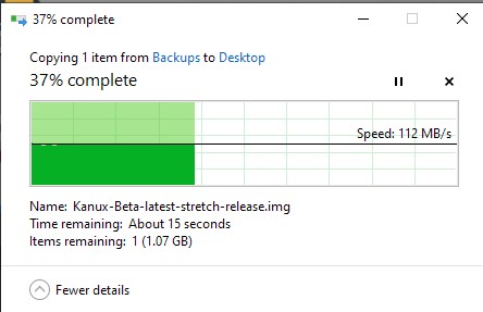

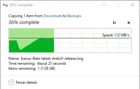

B) Copy performance is spotty at best. What usually happens is that large single file copy will start out very fast and then stall out for 5-30 seconds dropping to no transmission at all. It will then resume at full speed. I've attached a screenshot showing a 1.8GB file copy and the dip in transmission speed. While it doesn't look like it's stalling to zero bps, watching it live, it does. This was not the behavior that I saw while it was at work, or at home prior to the boot media update along with a few NW changes. With multiple files it seems like it will stall out on each file transmission.
