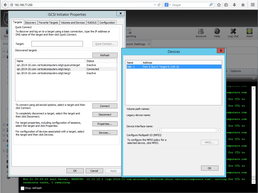

I have a two node hyperv cluster that I've been using for some time. I had to use another ZFS OS for a while, until the FreeNAS team switched over to CTL for iSCSI.
Anyway, a week or two ago, I went to add another target in iSCSI on FreeNAS. It wouldn't show right on the Server's Initiator side, so I reset the ctld service. After many restarts of both nodes and the SAN, one of my nodes cannot see the drives.
In the Server 2012 R2 iSCSI Initiator, under the given target->Devices it shows Disk -1 for the name of the device. I have MPIO setup of course, and when I add my second or third path that I have between the node and the SAN, it just adds Disk -1 again. From what I've read on MS forums, that's some kind of administrative device, but regardless, I've never seen it before. On the healthy node, the three LUNs I have presented all have three paths and non show Disk -1.
Note that the MPIO button is greyed out as well:

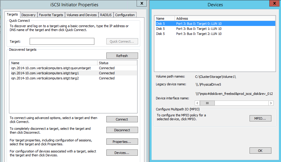

Here's what my healthy node, "hvtop" looks like:
FreeNAS does keep showing this warning:
Nov 21 00:28:22 san1 kernel: WARNING: 10.10.10.2 (iqn.2014-11.com.microsoft:hvbottom.chino.verticalcomputers.com): waiting for CTL to terminate tasks, 1 remaining
That warning repeats often, I think when I'm trying to add the target to the initiator on my problematic node "hvbottom".

Does anyone know how I can force terminate the "1 remaining" task that CTL is complaining about?
mav@
Sep 29, 2011
1,428
If it stops to complain after some time, then it terminates it by itself. That is not a problem by itself. Next builds should be less chatty.
