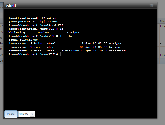

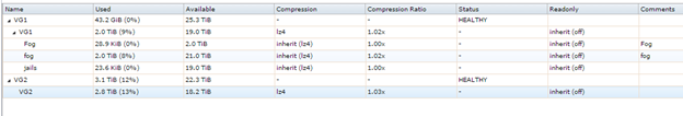

I have an iSCSI connection setup on a mac server and it has been working fine for months. All of the sudden it stopped. No changes were made to either the FreeNAS box or the mac server.. Just wondering if anyone could offer some insight..
here are some screen shots. The one this that looks odd to me it the share is a file and not a directory.. Thanks any help would be great..
