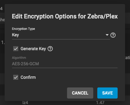

2) I use the "Key" method to encrypt my data [see image]. I have downloaded all my keys on my Mac just in case, to have a backup. Did I do it right? Do you have any suggestions?

If they have physical access while the system is powered on and the dataset(s) is unlocked, then you're likely hedging on the strength of your root/user password. (But that's not to say they cannot circumvent this.)
If you system is powered off and/or your dataset(s) is locked, then your data is inaccessible if you're using a passphrase instead of a keyfile.
If you're using a keyfile, you might not be out of the woods, since by default TrueNAS stores the keyfile on the boot device, in the plain. (This is by-design for TrueNAS, and not inherit with ZFS.)

To put it simply, you can't do that with TrueNAS (which is an appliance).
TrueNAS was designed to automatically unlock encrypted datasets at boot time. This allows the System Dataset and iocage dataset to be immediately available. On SCALE, ix-applications dataset is unencrypted, so it's a moot point (ever since recent updates to SCALE).
iXsystems does not want a user to break their system by creating a situation where the System Dataset, iocage dataset, and/or ix-applications dataset are unavailable if encryption is being used.
This is why you're left with three restrictions:
  • If the top-level root dataset is encrypted, it cannot be with a passphrase; only with a key
  • The key ("keyfile / string") must be available at bootup; hence, it is stored on the boot device, in the plain
  • Going forwards, new versions of TrueNAS won't even allow you to use encryption above unencrypted datasets in the hierarchy
If you're thinking of a custom layout/setup where the above concerns are no longer issues, then good luck submitting a feature request. It's very unlikely to be accepted.
