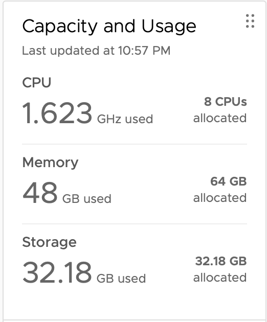

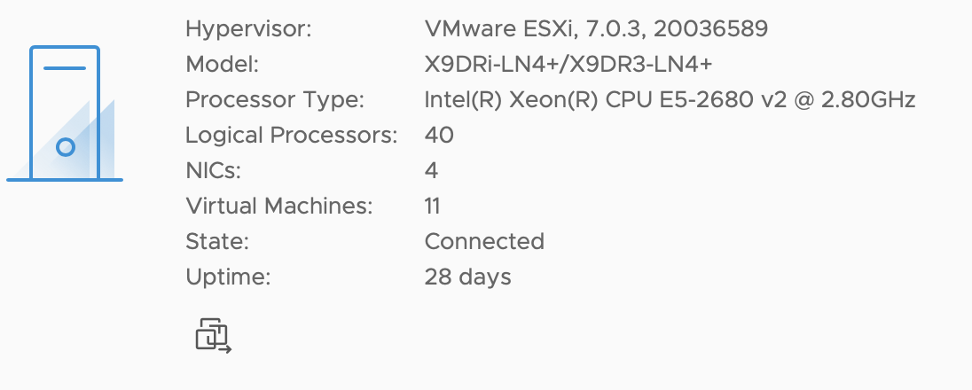

I have been virtualizing TrueNAS for years on server grade hardware (old SuperMicro X8 and X9 systems).
I followed all of the recommendations above and so far, I have not run into any "oh shit" moments. Key is to do it properly with good gear. This is very affordable today with used server grade gear.
I am now on ESXi 7.0.3 (started on 5.5) and it runs great.
I do give TrueNAS decent resources and passthrough my SAS2008 based HBAs. So far, all is golden.
Now, would I run it this way at work? Hell no. But for my personal use, it has been just fine.
