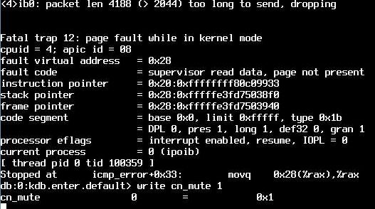

Hello all,
we have a problem on a FreeNAS iSCSI server (release is FreeNAS-11.2-U5).
We have a dual port Mellanox Infiniband ConnectX-3 card which is connected to a Infiniband switch (Grid Director 4036).
We have three Proxmox cluster nodes connected to the switch, which are running Proxmox VE 5.4-13.
The Infiniband cards on both ends are configured for connected mode with a MTU of 40950.
We are using a multipath setup with two subnets for IP over Infiniband.
This is working and we get a throughput of ~1-1.1 Gigabyte per second on each cluster node in parallel.
Sporadically we get a kernel trap on the FreeNAS server which is then rebooting.
This can happen from every hours up to 4 days.
The VMs are not crashing, they are in a delay until the FreeNAS server is online again.
Nevertheless we have to fix it.
The root cause is a packet over ipoib with a length >2044 bytes.
We are wondering where it comes from.
In a Linux Infiniband kernel documentation we found this:
In datagram mode, the IB UD (Unreliable Datagram) transport is used and so the interface MTU has is equal to the IB L2 MTU minus the IPoIB encapsulation header (4 bytes). For example, in a typical IB fabric with a 2K MTU, the IPoIB MTU will be 2048 - 4 = 2044 bytes. In connected mode, the IB RC (Reliable Connected) transport is used.
Connected mode takes advantage of the connected nature of the IB transport and allows an MTU up to the maximal IP packet size of 64K, which reduces the number of IP packets needed for handling large UDP datagrams, TCP segments, etc and increases the performance for large messages.
In connected mode, the interface's UD QP is still used for multicast and communication with peers that don't support connected mode. In this case, RX emulation of ICMP PMTU packets is used to cause the networking stack to use the smaller UD MTU for these neighbours.
Because of the overall performance we assume that we have multicast package problem here?
Has somebody any hint where we could look for the root cause?
Does anybody has an idea where the 4188 bytes packet come from?
Thank you in advance.

I should have to investigate in this problem and found out what is going on before I will report a bug anywhere.
I analyzed the FreeNAS crash dumps in /data/crash/ and found out that the last what is happening before the kernel is crashing are events like that:
<118>Fri Sep  6 05:20:07 CEST 2019
<6>arp: 10.20.24.111 moved from 80:00:02:08:fe:80:00:00:00:00:00:00:00:02:c9:03:00:09:9f:c1 to 80:00:02:09:fe:80:00:00:00:00:00:00:00:02:c9:03:00:09:9f:c2 on ib0
<6>arp: 10.20.24.110 moved from 80:00:02:08:fe:80:00:00:00:00:00:00:00:02:c9:03:00:09:20:e3 to 80:00:02:09:fe:80:00:00:00:00:00:00:00:02:c9:03:00:09:20:e4 on ib0
<6>arp: 10.20.25.111 moved from 80:00:02:09:fe:80:00:00:00:00:00:00:00:02:c9:03:00:09:9f:c2 to 80:00:02:08:fe:80:00:00:00:00:00:00:00:02:c9:03:00:09:9f:c1 on ib1
<6>arp: 10.20.25.110 moved from 80:00:02:09:fe:80:00:00:00:00:00:00:00:02:c9:03:00:09:20:e4 to 80:00:02:08:fe:80:00:00:00:00:00:00:00:02:c9:03:00:09:20:e3 on ib1
<6>arp: 10.20.24.111 moved from 80:00:02:09:fe:80:00:00:00:00:00:00:00:02:c9:03:00:09:9f:c2 to 80:00:02:08:fe:80:00:00:00:00:00:00:00:02:c9:03:00:09:9f:c1 on ib0
<4>ib0: packet len 12380 (> 2044) too long to send, dropping
It is every time the same behavior. The both 20-octet IPoIB link-layer addresses on all three Proxmox clients are changing from time to time.
After that it looks like that the FreeBSD server sometimes is using the Datagram mode for the new connections and then it tries to send a large packet over this connection which could come from a previous client request/connection in Connected mode.
The root cause seems to be the changing of the IP addresses/link layer addresses on the Proxmox client side and secondary the Datagram mode behavior on the FreeBSD side.
I will report that also in the Proxmox forum. Maybe somebody has an idea what is happening here with the link layer addresses and how to avoid that.

ifconfig for the both Infiniband ports on the FreeNAS server looks like that:
ib0: flags=8043<UP,BROADCAST,RUNNING,MULTICAST> metric 0 mtu 40950
    options=80018<VLAN_MTU,VLAN_HWTAGGING,LINKSTATE>
    lladdr 80.0.2.8.fe.80.0.0.0.0.0.0.0.2.c9.3.0.3a.ed.41
    inet 10.20.24.210 netmask 0xffffff00 broadcast 10.20.24.255
ib1: flags=8043<UP,BROADCAST,RUNNING,MULTICAST> metric 0 mtu 40950
    lladdr 80.0.2.9.fe.80.0.0.0.0.0.0.0.2.c9.3.0.3a.ed.42
    inet 10.20.25.210 netmask 0xffffff00 broadcast 10.20.25.255

getcom
Jun 3, 2019
10
Hello all,
I think I have found an answer to the address change problem on the Linux clients:
I found a comment on embeddedlinux.org:
  • A Linux host replies to any ARP solicitation requests that specify a target IP address configured on any of its interfaces, even if the request was received on this host by a different interface. To make Linux behave as if addresses belong to interfaces, administrators can use the ARP_IGNORE feature described later in the section "/proc Options."
  • Hosts can experience the ARP flux problem, in which the wrong interface becomes associated with an L3 address. This problem is described in the text that follows.
other sources:
http://www.mellanox.com/related-doc...OFED_Release_Notes-1.5.1-1.3.6_for_Oracle.txt
- When multiple vNics are connected to the same network, hosts can experience the "ARP flux" problem, in which the wrong interface becomes associated with an L3 address (FM #87335).
Workaround:
Set the following kernel configuration parameters: include the following lines in /etc/sysctl.conf and reboot the machine:
net.ipv4.conf.all.arp_ignore=1
net.ipv4.conf.all.arp_announce=2
https://downloads.openfabrics.org/O...release/OFED-1.4-docs/ipoib_release_notes.txt
3. Known Issues ===============================================================================
1. If a host has multiple interfaces and
(a) each interface belongs to a different IP subnet,
(b) they all use the same InfiniBand Partition, and
(c) they are connected to the same IB Switch,
then the host violates the IP rule requiring different broadcast domains.
Consequently, the host may build an incorrect ARP table.
The correct setting of a multi-homed IPoIB host is achieved by using a different PKEY for each IP subnet.
If a host has multiple interfaces on the same IP subnet, then to prevent a peer from building an incorrect ARP entry (neighbor) set the net.ipv4.conf.X.arp_ignore value to 1 or 2, where X stands for the IPoIB (non-child) interfaces (e.g., ib0, ib1, etc). This causes the network stack to send ARP replies only on the interface with the IP address specified in the ARP request:
sysctl -w net.ipv4.conf.ib0.arp_ignore=1
sysctl -w net.ipv4.conf.ib1.arp_ignore=1
Or, globally,
sysctl -w net.ipv4.conf.all.arp_ignore=1
For the running kernel on each client I executed following:
echo 1 > /proc/sys/net/ipv4/conf/all/arp_ignore; echo 2 > /proc/sys/net/ipv4/conf/all/arp_announce; echo 1 >/proc/sys/net/ipv4/conf/ib0/arp_ignore; echo 1 >/proc/sys/net/ipv4/conf/ib1/arp_ignore
I added the corresponding post-up lines to /etc/network/interface to get it permanent.
Hopefully the kernel trap 12 is gone now.
I received an arp address change message on server side every 1 to 15 minutes. This is gone now.
There are no such arp messages since 2 hours.
