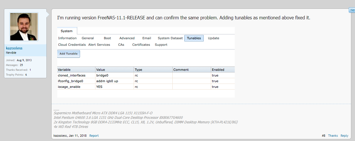

I'm running version FreeNAS-11.1-RELEASE and can confirm the same problem. Adding tunables as mentioned above fixed it.
