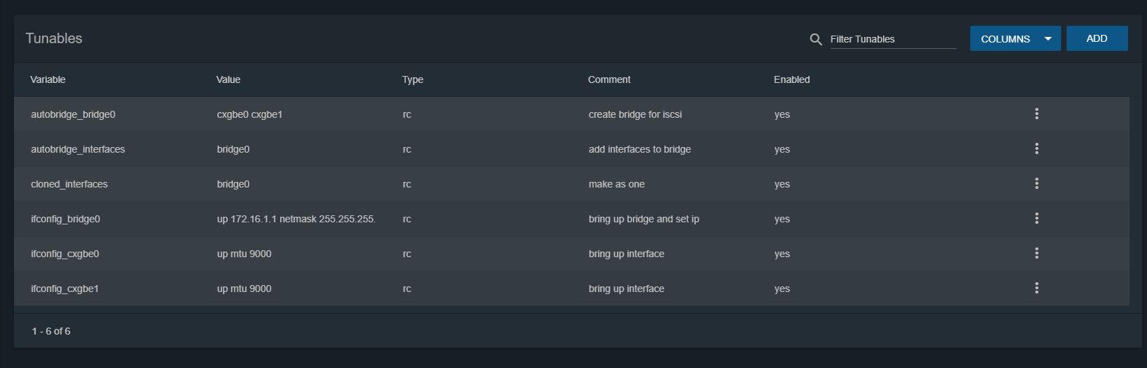

I will try to best describe my situation....I just recently updated my freenas SAN to version 11.2. It has a dual port 10gb network card that is directly connected to two hypervisors and configured with its own subnet in order to create iscsi sharing. In order to get the two hypervisors to see the SAN I had to create tunables to create a network bridge. I have attached a screen shot of the tunables.
That being said when I configure an iocage jail I am unable to ping my gateway and believe it maybe related to the tunables. I am wondering if I need to create a new interface for the iocage jails or use a different one. Below is a screen shot of the pings and the iocage settings that I have.

It may be useful to see the ifconfig from the host in addition to the jail... it seems that the jail network is OK.
I suspect the bridge on the host isn't properly set.
mrgtstr
Jun 15, 2016
25
Here is the output of ifconfig of the host. The vnet adpaters that are showing up I would of thought would of been deleted when the jail is deleted.

9,700
Your bridge has an IP address... I wasn't expecting that.
It looks like the only NIC you have with an IP address, bce0, isn't a member of the bridge... probably why you're locked in.
Perhaps it would be good to understand what is plugged to which switch...
Will try to explain my network configuration the best I can...
I have two onboard network cards and I am only using one for my local LAN (172.31.1.0/.24). I have a add-on dual port 10Gb network card that is directly connected to two xenservers to allow for iscsi sharing between the two xenservers. To my understanding In order for me to get the iscsi sharing to work with both xenservers I had to create a bridge using tunables in order for the dual port card to only have one IP address (172.16.1.1).
9,700
I think you want to do LAGG (there's a whole different thing for that) to get the 2 NICs to cooperate. The bridge for your jails needs to bridge the jails and the LAGG interface (and should not need an IP address).
After briefly checking into LAGG, I will see if that will help my issue. The only caveat I see is the network cards are not going into a switch for VLAN tagging and are directly connected to another server.
Thanks for your time! Will see what happens.
mrgtstr
Jun 15, 2016
25
Out of curiosity after changing the tunable settings for the bridge adapter from 0 to 1 the network for the jail started working. If it happens again will see about configuring LAGG.
