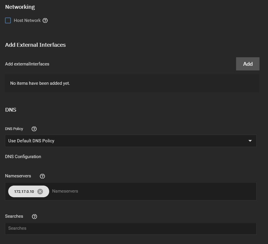

Its not set to use host networking - i just double checked in the UI - that box is *not* checked. Am I missing something here?

I tried adding the kube dns service to the list of nameservers but that didnt make a difference.
So you say this container is using host network - what am I missing here?

@StanAccy yes: Get rid of that manually set Nameserver and try again.

Nameserver setting has no impact - I added that as a test to see if it had any impact - it seems to be an additive process to `/etc/resolv.conf`.
