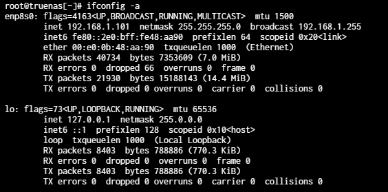

I am a new user of this software. I have added a new NIC to the system but I am not able to see and configure it.
I am running TrueNAS-SCALE-22.02.1
The card shows up on the PCIE list
But nothing on the config
I can also confirm it shows up in the bios.
What would I do next to get the NIC configured?

I'm having the same issue. shows up under lspci but nothing under ifconfig.
The i225 NIC shows up in the BIOS.

Hey Delta, I found it is likely a problem with the driver. I had a spare TP Link TG-3468 lying around and scale picked it up straight away (definitely failed on core) so I just use that I suppose til the driver is fixed. They only cost $20.
