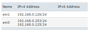

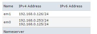

Quiltface
Mar 18, 2016
21
how can i get rid of the .125 and .126
