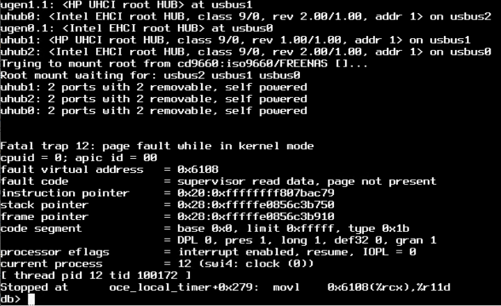

Hello,
when i try to install FreeNAS 11.2 i get this Error:
I have a HP DL380e Gen8 Server with all Firmware Updates. I will install FreeNAS on a SD-Card.
Thanks for help! :)
PhilippSch
Feb 16, 2019
Hello,
i get the error before i can start the installation. I transfer the ISO with iLo Virtual Media.
When i boot the old install Image "11.1" i get no error.
Thanks
