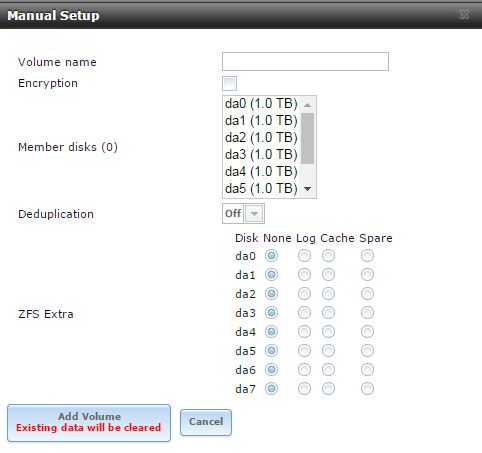

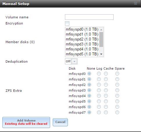

I've just done that
Be prepared to backup the data and rebuild the pool when you get the new controller. FreeNAS is unlikely to recognize a pool build from a set of RAID0 pseudo-disks when the original controller is replaced.

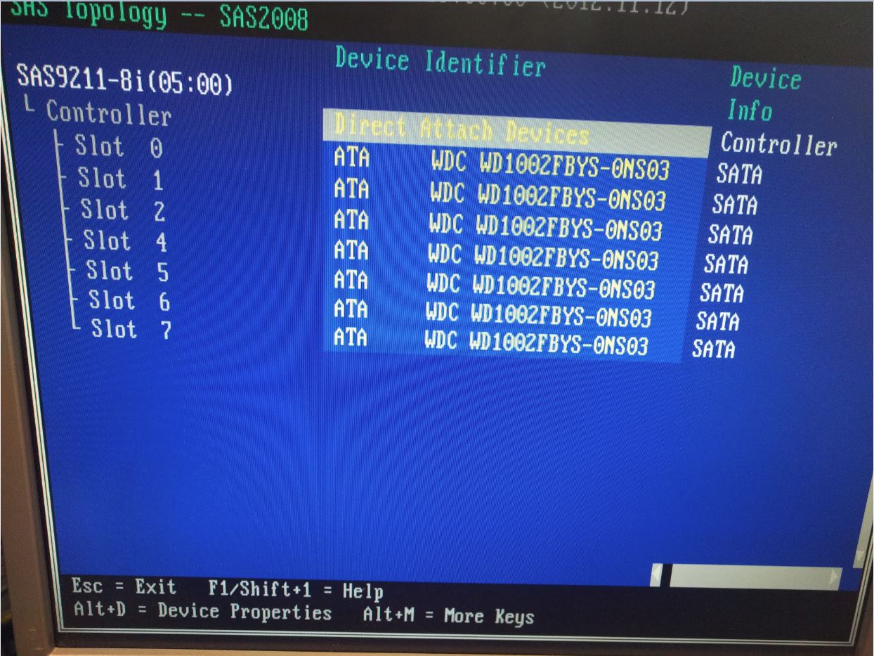

Sorry I spoke to soon :-( :-(, it looked ok but I've just come create a raid through FreeNAS and noticed that 1 of 8 drives is missing. It's the last drive (Slot 7) but according to the LSI configure Slot 3 is missing?!?!? Everything was visible until i did the IT mode.
I switched drive 6 with 7 to see if it was a bad drive or slot and it appears to be the slot.
So config the physical slot 6 is shown as slot 2 and slot 7 is shown as slot 3. Is that normal??
See attached, slot 3 missing but it's actually slot 7.
James.
