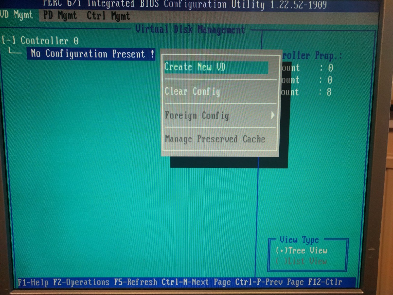

Hello,
Just installed FreeNAS 9.3 and I can't see any of my drives at all, I've not configured any RAID from the controller option when you press CTRL+R from first booting the server.
I've cleared all the raid configuration and changed several settings in the bios to get them to appear but I can't.
I know they will appear if I RAID them from the controller card software but I don't want to do that do I.
Thanks
James
Robert Trevellyan
Pony Wrangler
May 16, 2014
3,778
Correct.
What options does the card give you when you Ctrl-R during boot?
Most likely flashing the controller to IT mode is the best option with this hardware.

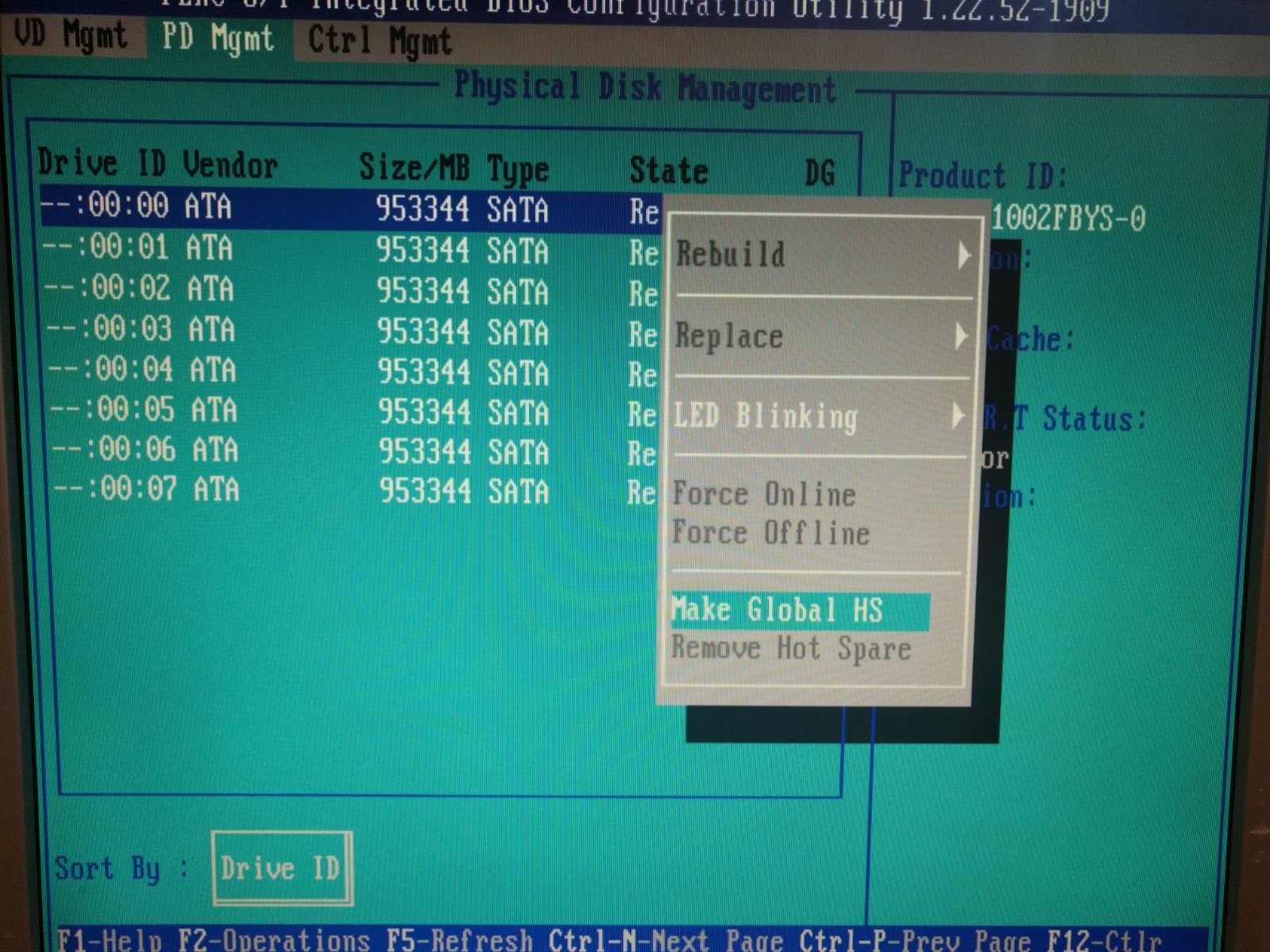

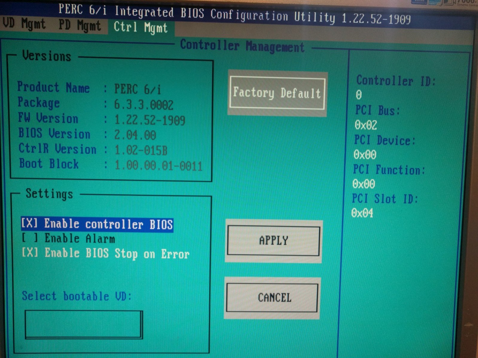

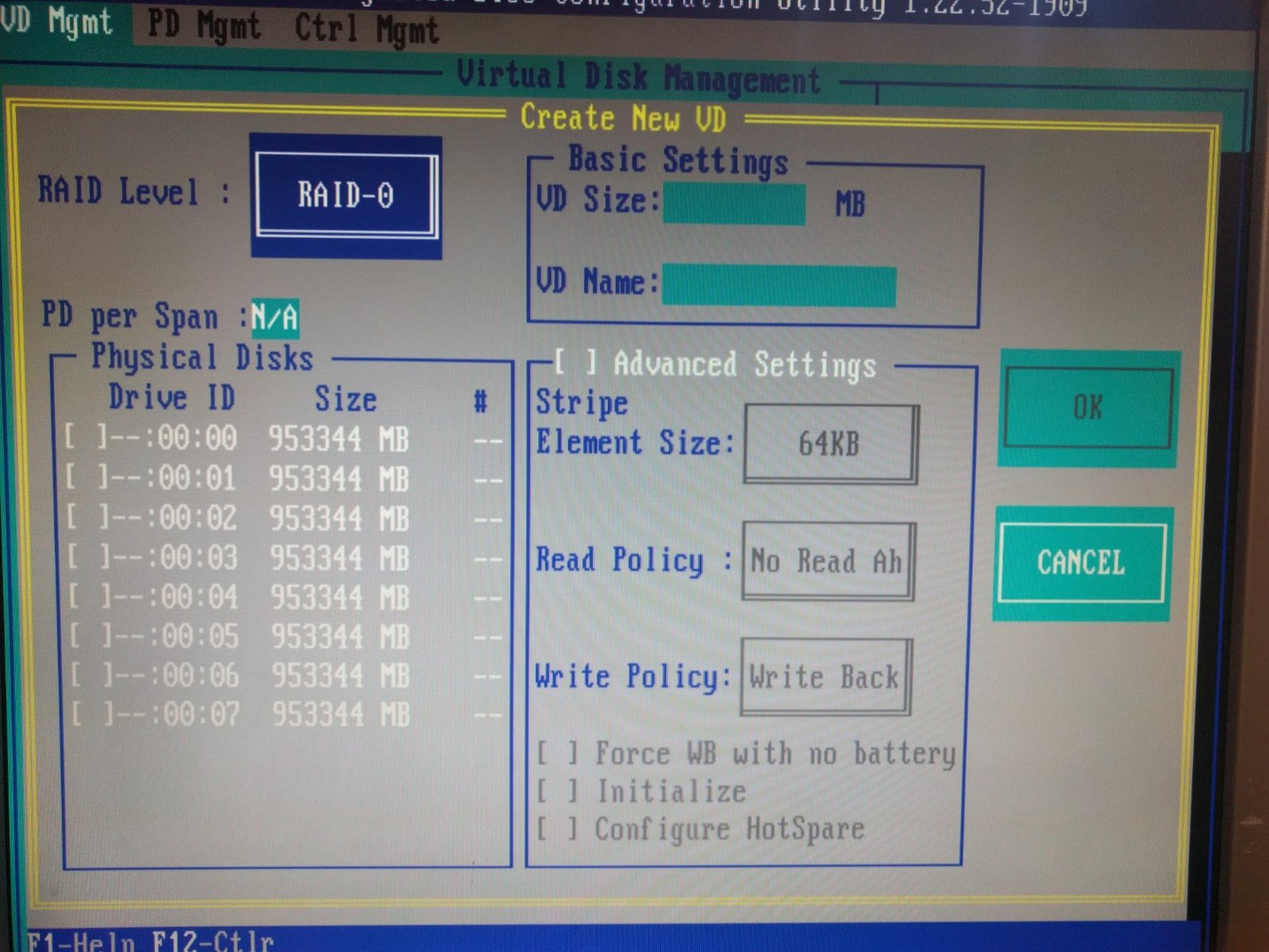

Hi Robert,
I've taken a few pictures of what options i have but i think i may need another controller, i did untick "Enable controller Bios" show in the 2nd picture just to see if that did anything and that didn't help :(.
On my test server i changed the embedded controller in the BIOS from RAID to SCSI and I could see the drives after that but there doesn't appear to be that option, just a SATA setting, which is "Off" or "ATA".
Thanks,
