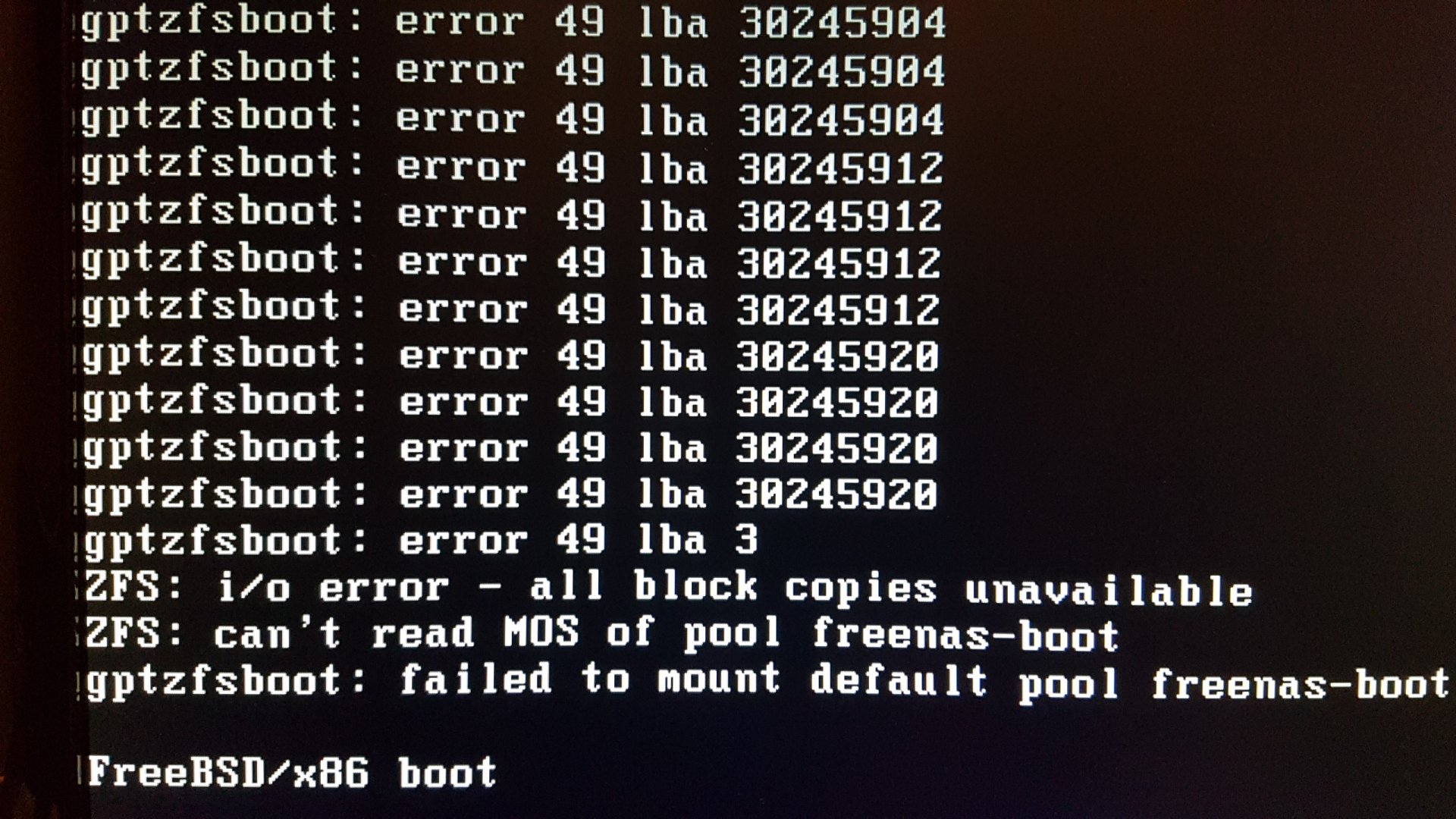

Hi sorry, it took so long for me to reply back. many thanks to both of you helping.
now i am getting into a new problem, which i think is weird.
I shut down the freenas which was working OK for the whole of last week, and just a few days ago, after weekends, we started the freenas back online, and this is the error I got.. and there is a blinking underscore waiting...
fannlow
Jul 22, 2019
26

i installed freenas on legacy, so i didn't use the "left option" when it asked if I wanted to use UEFI instead
fannlow
Jul 22, 2019
26
so, do I clean my two usb drives that I have mirrored during installation?
and reinstall a clean freenas os, that runs on UEFI, and also enabling my motherboard UEFI boot?
not sure how to avoid this gptzfsboot error in the future...
but my 2x usb sticks are now having I/O error when my windows tries to clean the sticks...
hope i get some help for both the issues o_O
thanks in advance for any help or directions I can read up on

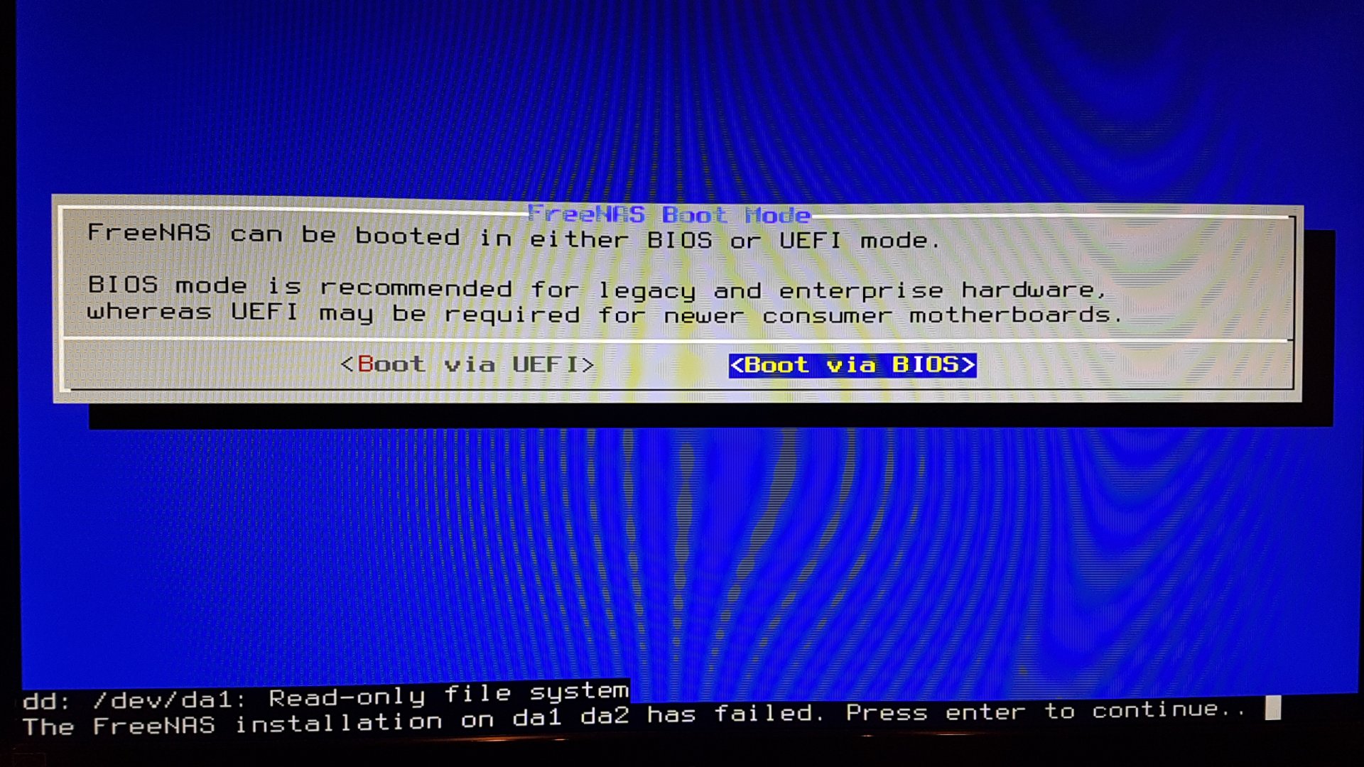

this is what i received from freenas after I tried to reinstall, using the same 2x usb sticks (both new, under 3wks old, been used only for this purpose.) I am now unable to install as both da1 and da2 has failed.

I'm not a windows user so I don't know what cleaning a disk entails. In general though I would suggest you allow the FreeNAS install utility to fully control the boot disks. If any formatting etc needs to take place the install process will take care of it.
Intel DZ68DB
You may want to try booting with UEFI given the hardware. The nice thing about the install process is that if it doesn't work in one mode you can try it again in another.
