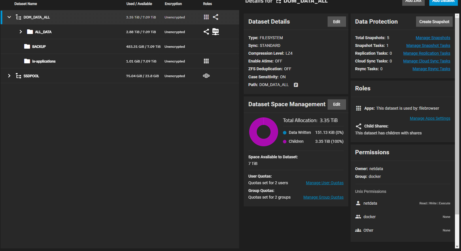

I had permissions set up, they worked. I did something that made them stop work. That something was remove the IX apps folder from the dataset.
Now I can't SMB as admin, nor any user. I can't even grab the files with filebrowser. It simply doesn't have access. I have snapshots enabled, will they most likely fix this issue?
I only want to access the files so I can back them up and then rebuild the whole dataset, since it's a mess and a half. In the screenshot there's the permission errors. It should be Root everywhere. Isn't there any way to fix this?

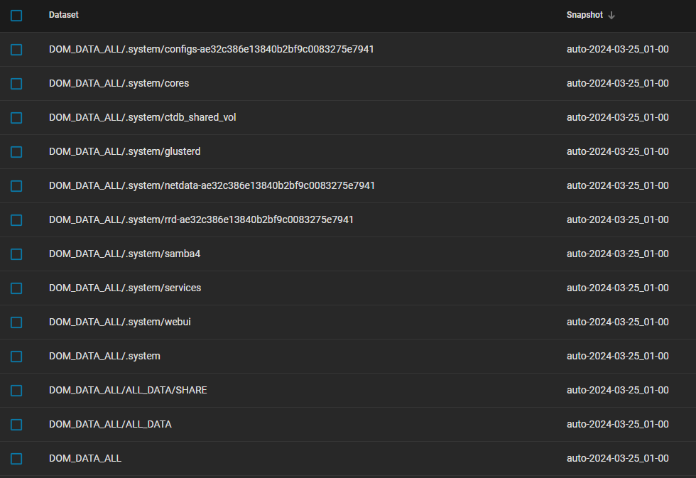

If I were to use the snapshots, is there any specific one I'd need to rollback? Here's all of them. It's the first time I've had to resort to snapshots and rollbacks.

Don't rollback any snapshots. Go to the Shares Tab and post a screenshot of the ACL settings for your shares your cannot access. Let's work from there.
If you can proceed without further guidance, basically what we're going to do is, verify the users that should have access are still listed with the appropriate permissions, if not add them, and then apply the permissions recursively.
As long as you have access to the GUI this is nothing that can't be salvaged.
Typically the owner and group is root, why did you change that?

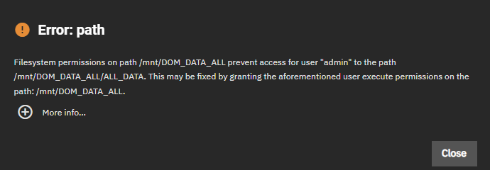

Here's the error I've been getting before my actions:
This error would happen if some user DIDN'T have root access.

Also the error message gave you the clou, probably your user you used to access the data (did you use admin for SMB?) didn't have the execute permission. The execute permissions enabled changing directories.

The error message looks like you did a manual "chmod 770" or such on the /mnt/DOM_DATA_ALL. This will break access (not just SMB) for all non-root processes. There are unfortunately some prominent youtube howtos that quite ignorantly say to do this. What is the output of stat /mnt/DOM_DATA_ALL?
In fact execute was enabled. Everything regarding read/write/execute was enabled, hell, even sudo was enabled and I still couldn't gain access through any user other than root. Only granting root to some user (through groups) made everything click.

I can't imagine that deleting ix-applications screwed up your permissions. Did you also delete the system dataset? As far as I'm concerned the ix-applications dataset isn't related to the permissions. And also I'm not sure if the latter only holds information on the SMB permissions. Some people here, me included seem to leave smb as it is and change the file permissions (ACL).
Yeah, I did not think anything would break too, yet it did. There wasn't any system dataset on there as far as I know. Apps like filebrowser from truenas also stopped working. It couldn't and still can't gain access to that directory at all. I also just leave SMB and configure ACL, this dataset was configured through ACL without any code from my side or anything. One issue I noticed, Immich was not able to create additional storage on that dataset, so that might've hinted at some problems already.
