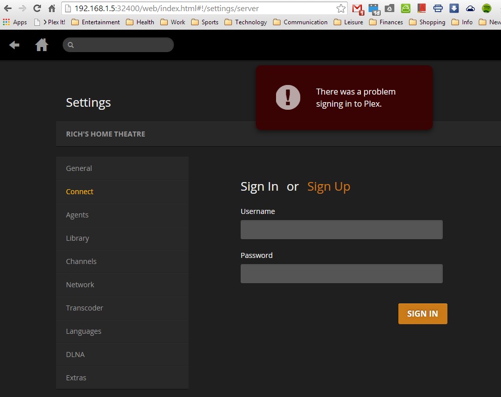

I've attached below a screen grab of the error message I get each time I attempt to sign in..

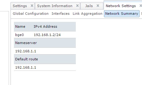

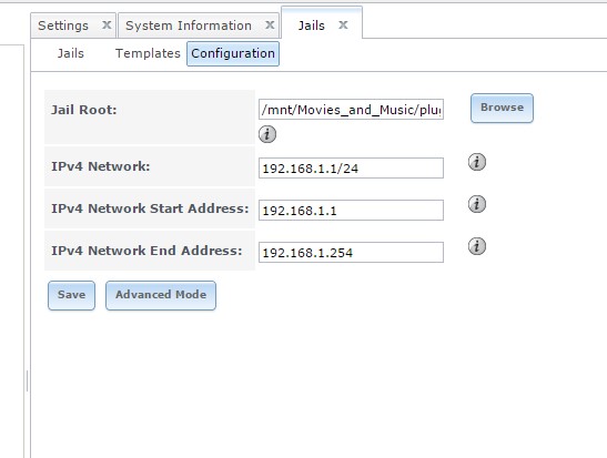

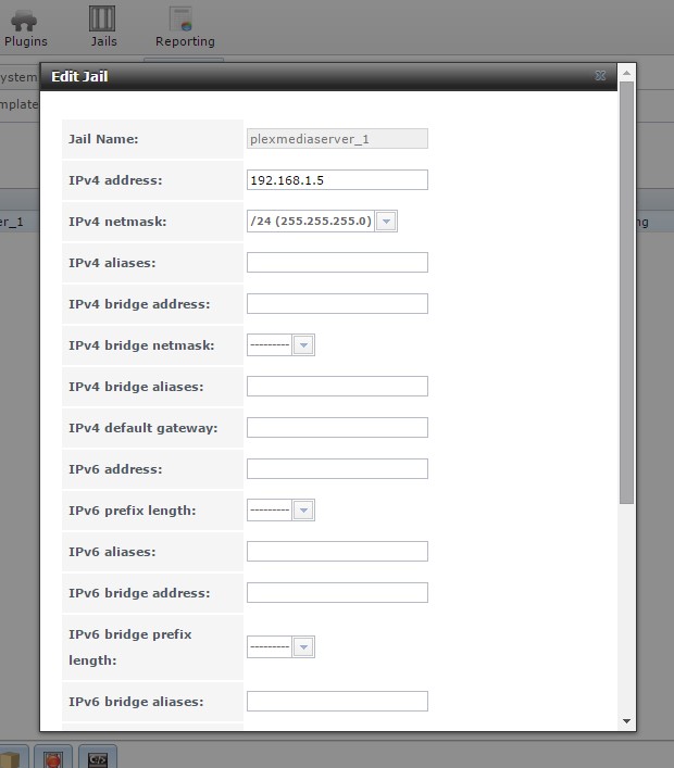

Here are grabs of my Freenas network settings, as well as my Plex jail and my jails config...

On jail/plugin creation the gateway settings are placed in the jail in a file (sorry, I forget the filename). If you later change your gateway you must manually change the setting in every jail. It sounds like your gateway's IP has changed, so you might have to do this...
