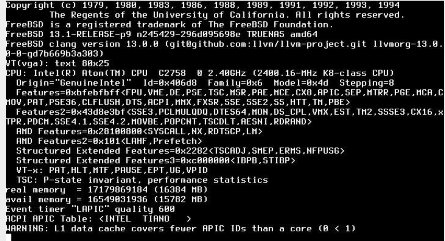

Brilliant idea, @Stux . I pulled the pool physically and booted. But it didn't work, maybe for the System Dataset reason. Booting froze in the early stages, at the point below. (I'm doing this over iKVM so can't copy the text, just images)

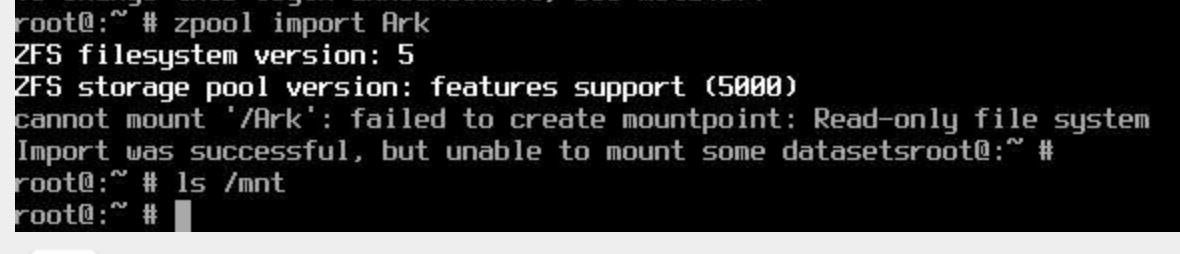

I put the disks back in, and managed to set up a FreeBSD image on USB stick. It gives the option to work live instead of install. Problem there is, it will import the pool, but no datasets (there is no encryption). I tried with simple zpool import Ark, and then with more explicit zpool import -f -R /mnt Ark. Same result:
So I'm stuck now. ????

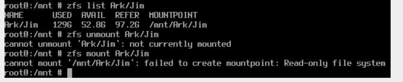

With zfs list I can see the dataset I want, but zfs mount won't mount it. Using the -f option doesn't change that.
