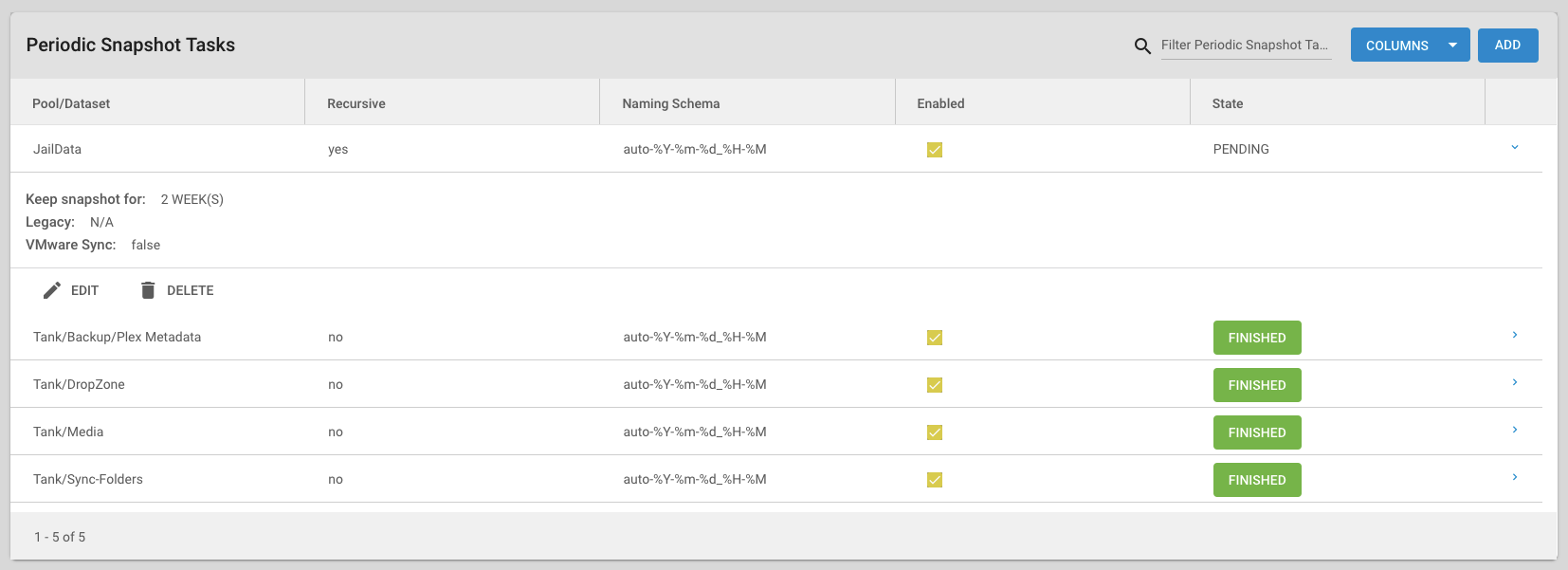

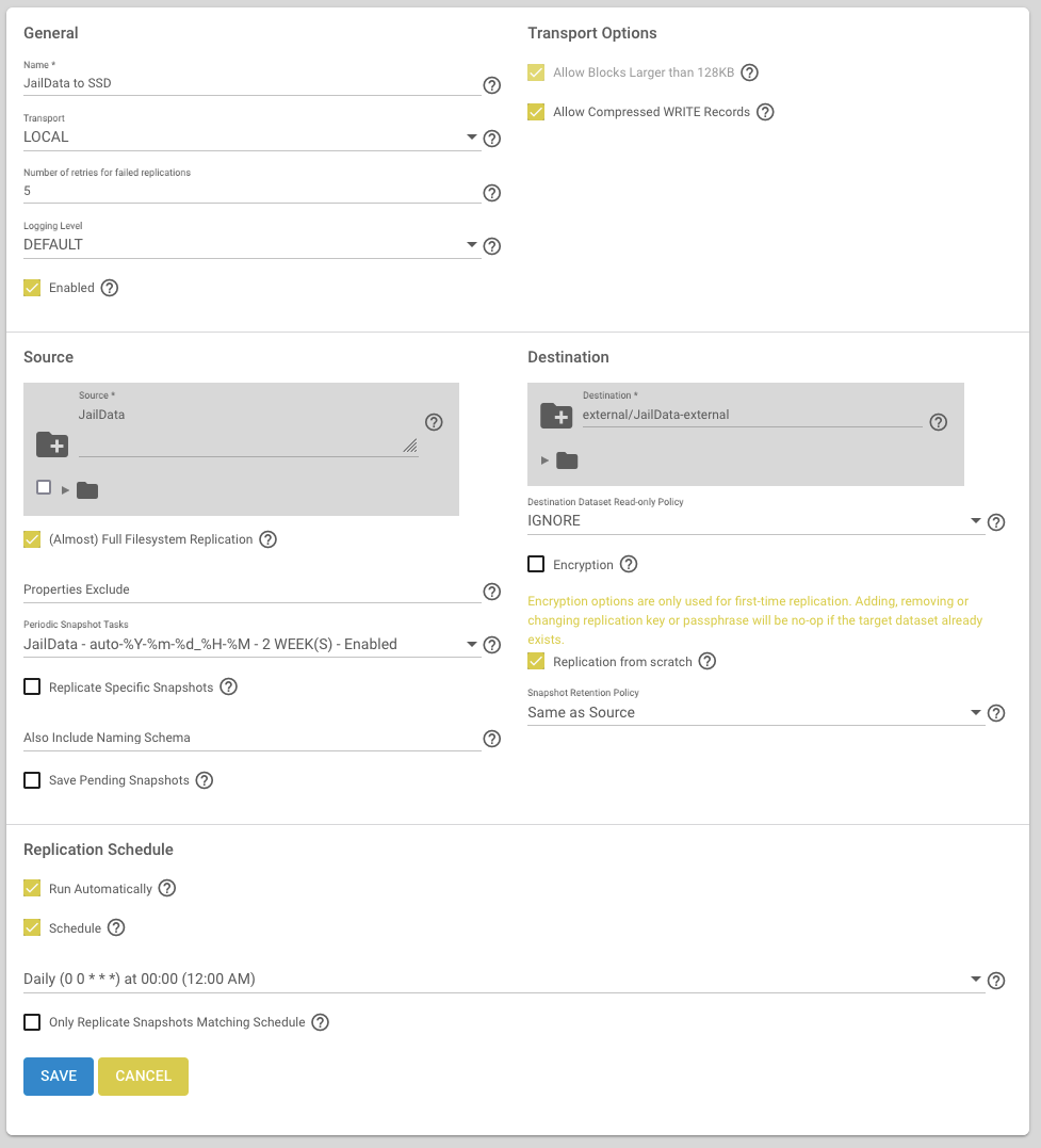

Hmm... I deleted a bunch of old snapshots and snapshot tasks to start fresh. I created a brand new replication task, which as I understand it, should also create the snapshot task. When I then run the replication task, though, it still fails. Here's the error:
Dataset 'JailData' does not have any matching snapshots to replicate.
Screenshot of the replication / snapshot tasks included... As you can see from the screenshot, the JailData task doesn't work. It shows as "Pending."
The logs are basic and show that there are no snapshots. Again, though, this works for every other replication task I have.

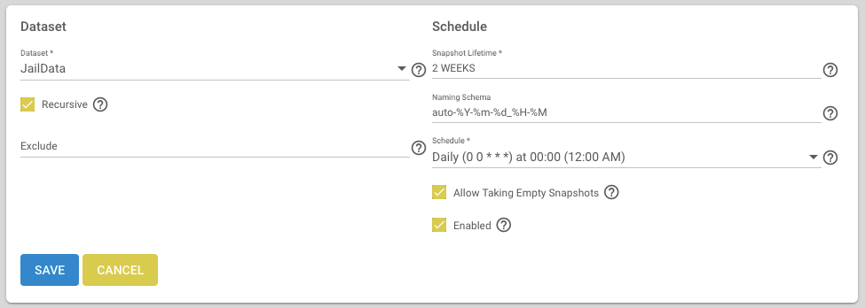

Here's the screenshot of the periodic snapshot task. Pretty basic, and it looks the same as all the other snapshot tasks. Is there a chance this has something to do with this being my jails pool?
Oct 22, 2019
3,641
I wonder if the snapshots were even created?
Do you see the relevant ones in here?
zfs list -t snapshot -r -o name JailData
